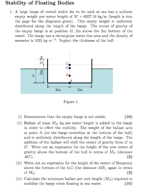

A large barge of overall width 4m to be used at sea has a uniform empty weight per meter length of M=6327.19kg/m (length is into the page). This empty weight is uniformly distributed along the length of the barge. The center of gravity of the empty barge is at position G, 2m above the flat bottom of the vessel. The barge has a rectangular water-line area and the density of seawater is 1025 kg/m^3. Neglect the thickness of the hull.
Ballast of mass Mb kg per meter length is added to the barge in order to effect the stability. The weight of the ballast acts at point A (on the barge centerline at the bottom of the hull) and is uniformly distributed along the length of the barge. The addition of the ballast will shift the center of gravity from G to G (prime). Write out an expression for the height of the new center of gravity above the bottom of the hull in terms of Mb (distance AG(prime))
I know that the key word in the question is 'acting on point A'. Adding Mb will shift G to G(prime) however G(prime) is lower than G. Because the weight was added below and not above.
I am aware that i need to use moments to find G (prime) but am not sure how to start it off..Really stuck
I have found the draft value of h=1.5432m.

The location of G is given as 2 m above the bottom of the barge, and this is for the empty barge. If Mb of ballast is added with a center of gravity of zero meters above the bottom of the barge, what is the height of the c.g. of the barge and ballast together?
If you look at the attached diagram it shows the height from point A to the new center of gravity to be h.. That's the value I found in the above calculations which is, h=1.5432m
I think you are misreading the figure attached with the problem. The height of G for the empty barge is 2 m above the bottom of the barge. You are asked to find out how much ballast to add to the barge so that G', the center of gravity of the barge with ballast, will produce a stable condition. The value of G' may not necessarily be equal to the draft h.
Hi SteamKing, just realized that you are completely right. I assumed the height stayed the same but the G' has moved so h is probably not equal to the draft h.. Because the question specifically asks 'write the expression for the height of the new center of gravity above the bottom of the hull in terms of Mb(distance AG')) i have no idea how to obtain this. Any starting points you would recommend?
The height of the center of gravity of the empty barge plus ballast can be found by writing the vertical moment equation, using point A as the reference.

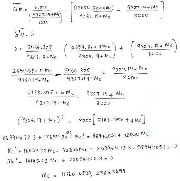

When i tried to solve this, G'M=0 and I couldn't because I had a few root problems where it clashed with the Mc value.
Can you help please??
Your equation setup looks good. When G'M = 0, the equation will simplify to a quadratic in Mc. Check your signs and arithmetic when simplifying.
Specifically speaking would you say that my moment equation is correct? I think that's the main part of the working out that has to be right as i use the result obtained in the following sections to calculate G'M=0
Your moment equation is correct. I suspect you earlier problem trying to solve for Mc was due to an incorrect sign or an arithmetical mistake. If you post your calculation, I can offer further help.
G'M= 5.33/((9327.19+Mc)/1025) - [(12654.38 + 4Mc)/(9327.19+Mc) - ((9327.19+Mc)/8200)]
G'M=0
(12654.38+4Mc)/(9327.19+Mc)-(9327.19+Mc)/(8200)=5466.325/(9327.19+Mc)
(12654.38+4Mc -5466.325)/(9327.19+Mc)=(9327.19+Mc)/8200
(7188.055+4Mc)/(9327.19+Mc) = (9327.19+Mc)/8200
(9327.19+Mc)^2=58942051+ 32800Mc
(9327.19^2)+(2x9327.19xMc)+Mc^2=58942051+(32800xMc)
869964733+18654.38Mc+Mc^2=58942051+(32800xMc)
-50242403.67+Mc^2=14145.62Mc
Mc^2-14145.62Mc-50242403.67=0
I used my graphics calculator and found
Mc= 17086.153,-2940.533
So since we can't have a negative number the max the cargo can be is 17086.153kg..Would you be able to check this? Thank you soooooooooooooooo much!
There's an error in your equations when you collect terms to form the quadratic in Mc. Can you spot it. It changes your answer. BTW, always check to see if the barge has enough volume to support the empty weight plus ballast and cargo.
I tried solving it again and don't think I succeeded. I have attached a scan of my working out so it's easier to read.. Please tell me what I am doing wrong. I think I've solved this like over 10 times and keep finding different answers each time :(
You have obtained the correct equation in Mc to solve. Although it is not obvious by inspection which of the two solutions for Mc is correct, you do have one condition which must be satisfied: the barge must remain floating when loaded with cargo and ballast.
How do I go about showing that? I tried substituting the values into the previous expressions to see if all the conditions are met but couldn't get much out of it to come to a conclusion.. What shall I do?
Read the question again and found that the question asks for the maximum mass of cargo, so since we found 2 masses that satisfy the G'M condition wouldn't that mean that the heavier mass is the answer to Mc. Thoughts?
So Mc=11760 kg/m ?
If you use the larger value of Mc as the amount of cargo which the barge carries, does the hull of the barge have enough buoyancy to float? (Hint: determine the draft required to support the weight of the barge, cargo, and ballast and see if the hull is sufficiently deep)
I did all the calculations for it and found that Mc=2385.5699 kg/m. I really appreciate your help! Thank you soo much
