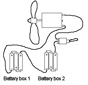

Here's a simple wiring diagram for Alex. Sorry about the crude drawing. :blushing:
This shows three batteries per battery box, but you'd use the same 'nose to tail' connections for the batteries, no matter how many you use.

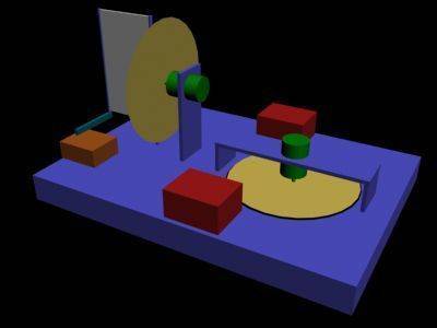

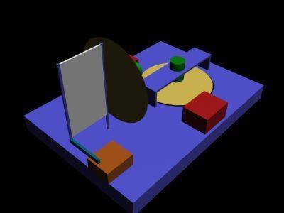

I've made some simple 3d models over how i thought i might build a hovercraft. I'm not that skilled in modeling and 3d studio is not supposed to be used for this, but anyway... :-p
The blue/purple stuff is s upposed to be balsa tree and some kind of rubber. the yellow circles are the propellers, the motors are green, battery packs red and the orange thing is a servo. I'll probably add an antenna and a servo to control the speed of the engine used to move it forward.
I was thinking to use 2 '400' engines with günther props as you said would be a good idea. The power should be supplied from the two 7,2 v battery packs. I think i will power the servos from one of the two packs. The picture should be in scale if I'm not mistaken.
Are there any direct problems with this design?
Should i use the servo to move the whole engine instead to steer or should i do it this way (use the servo to move a rudder).

I think that's great swither. Nice work! :smile: :smile: :smile:
I think for an R/C version, with two motors, it might be better to run both the motors off the same battery pack (wired in parallel), and then it would probably be better to use the next size up of battery (the common ones are called Sub-C cells, and you can buy a ready made pack of 6 or 7 of these cells shrink wrapped together - they are often used in R/C model cars.)
Also, to carry the extra weight of the second motor, the bigger battery pack and the radio control gear, you might have to increase the area of the hovercraft a bit - maybe go to about 15 inches long and 10 inches wide.
You would probably want to use an electronic speed controller for the thrust motor at least (so you could slow down) - maybe another one for the lift motor as well. These electronic speed controllers also have a 'battery eliminator' circuit built in. This regulates the 7.2V or 8.4V from the battery pack down to the 5V that the receiver and servo use, so there is no need to carry a separate small battery to power the receiver and servo.
I think your idea of the rudder is easier to engineer than trying to pivot the whole thrust motor around. Maybe you could have two or even three rudders in parallel behind the drive motor (all worked by the same servo) and this would give you more powerful steering.

this one is actually 35x25 cm, so i hope it will be sufficient. i first thought of making it smaller, but when i realized that there will be extra weight from the servos and so on i made it bigger.
i was thinking of using a speed controller for the thrust motor but just set the lift motor to what's needed to make it levitate and leave it there while it's on, i mean, there won't be any real reason to change it while it's in use right?
thanks for your adviced by the way:)
  • #35
If the radio gear you intend to use has a third control channel, then it would be nice to control the lift motor too. Then if you are heading towards a wall at high speed, you can switch off the lift, so that the hovercraft sits down and stops.
But I agree, it's not essential - the main two controls you want are to vary the forward thrust and the steering (rudder) control.
I'll be interested to see how you get on. If you go ahead and make it, perhaps you can post a photograph of it? That also goes for Alex, and anyone else who makes one as well, of course.
