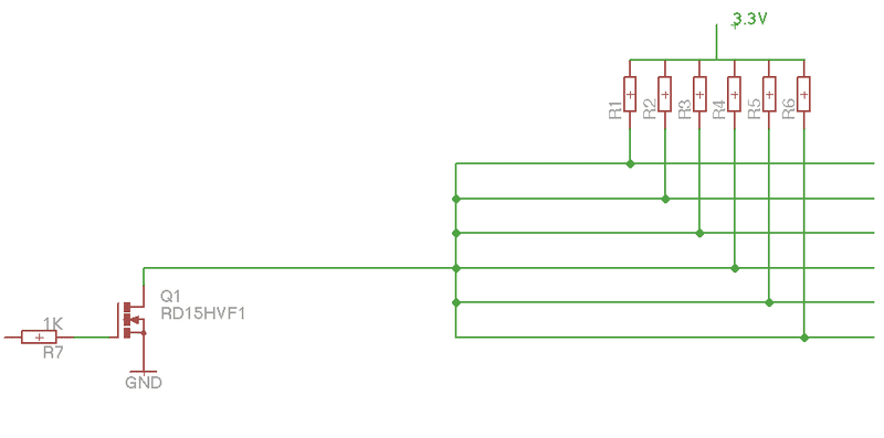

Okay, each wire will have a 4.7K pull up - the MOSFETs are used in Open Drain config. This pull up is located on the receiver side of the board. So, it's a bit like this:
Output -> Buffer/MOSFET -> Harness -> Pull-up Resistor -> (termination?) -> Input
Now here's the thing, for a single wire obviously the current isn't that much it's just 3.3V/4.7K = 0.7mA.
However, this was assuming that all the wires in the harness are one-to-one. This is, of course, not always the case. Suppose there is a junction that has 50 wires. This junction will be connected to the driving end via 1 wire and the 50 wires will be connected on the receiving end. When the CPLD drives the walking 1 onto this wire, the transistor will need to source
3.3/4.7K * 50 = 35mA.
A simpler way to look at it is that the CPLD pin will be activating 50 pull up resistors in parallel. Even this isn't an issue - the real issue comes when there is a fault in the harness, the very thing the circuit needs to detect. Suppose this 50 contact junction is short circuited with another 50 wire junction. Suddenly, we don't have 50 pull ups in parallel, but a 100. Can you see how this gets out of hand? But remember, no matter what, only one output will be activated because the test vector is a walking 1.
Sure, I could use a weaker pull up, but the current isn't an issue because I've already found a logic-level MOSFET that has a absolute max. I(DS) of 700mA, so I'm okay around here.
The wires can be twisted, but they can also be single. They can even be shielded - it depends on what the customer requires and is out of our hands.
Coming back to the current... the current doesn't go anywhere, it just runs through the harness and goes to ground through the MOSFET.
Here's a rough outline of what I said:
The resistor at the gate is connected to the output of the CPLD. The wires at the drain and onwards till the pull ups is symbolize the harness. The right hand side is connected to the input/receiving side.
Does this make things more clear?
