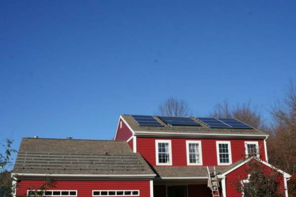

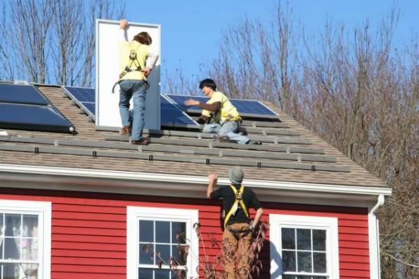

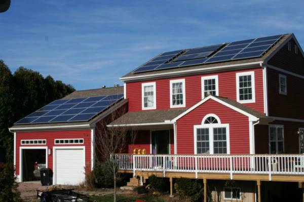

The panels are up. 7kW system will be 110% of our electrical needs. Grid intertie, no batteries, no pile of money up front: $109/month for the next 15 years.
Plus dig the new deck I built last summer.
--Chi "Happy Homeowner" Meson

Damn, what a nice, big house! I love the deck and congratulations on the solar!
Yeah. That's a sweet house Chi! Where do you live out of curiosity? New England?
EDIT: Just read your profile. I am waving from the next state over! :smile:
Speaking of the nice deck, is that TREX?

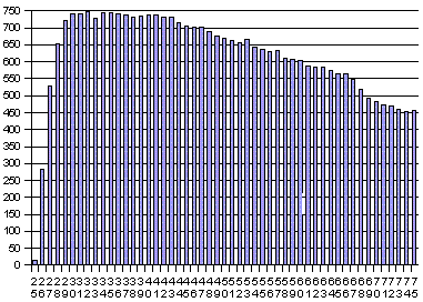

http://www.reuk.co.uk/Effect-of-Temperature-on-Solar-Panels.htm
Assuming the reflectivity of 5% of black panels and at say 30 degrees relative lattitude they absorb 0.95 * sine(45) * 1360 W/m2 = 911 W/m2 at noon. Stefan Boltzman transfers this to a temp of 356K or 83 degrees C, so the effectivity may drop 30% or something, due to the heat.
I guess it would be a double whammy if the panels were liquid cooled, the heat of the water being stored under ground.
Andre said:
Please don't shoot the messenger.
Assuming the reflectivity of 5% of black panels and at say 30 degrees relative lattitude they absorb 0.95 * sine(45) * 1360 W/m2 = 911 W/m2 at noon. Stefan Boltzman transfers this to a temp of 356K or 83 degrees C, so the effectivity may drop 20% or something, due to the heat.
You are assuming that 100% of the energy goes to heat.
No the sad lessons learned by my brother in law.
No, you took the total incident energy and assumed that it all heats the panel. That is incorrect. The panel is producing power.
Also, where did you get 1360 Watts. That seems too high even for the total incident power per sq meter.
No I did not
I merely looked at the graph in the link
Experiment Results - How Does Temperature Affect Solar Panel Power Output
Note that 83 degrees C is off the scale
Also http://www.jsgregg.com/teaching/GEOG345/Assignments/Examples.pdf , so I was 10 W/m2 too low for the safe side.
But we have indeed to substract the energy which is converted to electricity. 6-12% and for 12% the numbers would be 802 W/m2 remaining absorbed energy gives 345 K or 72C
