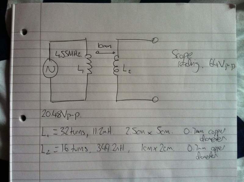

I'm designing a wireless charging system, and I've managed to take some measurements between two coils for the voltage transfer, but the signal generator I'm using doesn't seem to output any measurable current.
What could I do to it, or what could I design from scratch that would enable me to select a frequency around 4MHz which could drive about 500mA at 20Vp-p?

One coil is 5cm by 2.5cm with 32 turns of 0.711m diameter copper.
The other is 2cm by 1cm with 16 turns.
The voltage output is 20Vp-p with it failing to drive even 10mA out of it (although it doesn't specify anywhere it's actual limitation - not that I can see anyway).

how about drawing up your circuit. Annotate it with components used, voltages and currents at key points etc
then we can all visualise what you are trying to achieve :)
its going to be much easier that way, than playing 20 questions ;)
Dave

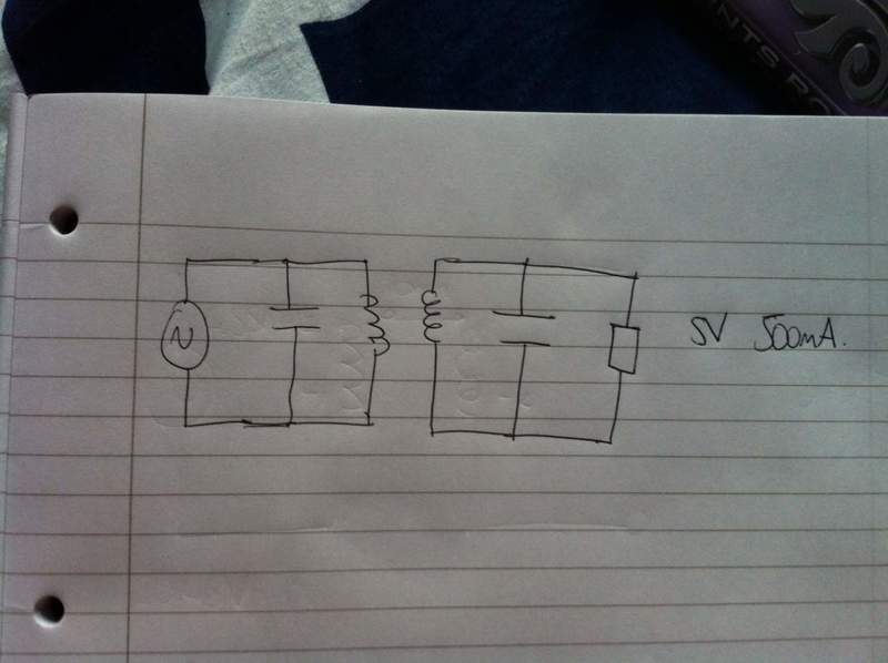

I've attached an image of the circuit (photo.jpg).
When I place an Ammeter in series, even when putting a resistor (tried values from 10Ω to 1kΩ) I don't get any reading on the meter.
I suppose what I think I'd like to come up with eventually is seen in the second attachment (photo2.jpg). Understandably I'll need to rectify the signal, but I've managed to build that circuit already (although I've been told I'll need shotkey diodes instead of 1N4001 to allow for the high frequency?)

Since you are using a signal generator as your signal source, you need to be driving a series tuned circuit, not a parallel one. Signal generators have low output impedances and this damps a parallel tuned circuit and stops resonant effects.
Series tuned circuits work best with a low impedance drive.
You could try 220 pF or anything like that that you have on hand. You could use a variable capacitor of about 400 pF maximum for this.
Then tune with the signal generator for maximum voltage across the left coil.
Make the second coil identical to the first.
Now, since you want to drive low resistance loads, you should also use a series tuned circuit in the secondary.
This time, though, the frequency is already fixed, so you need to adjust the capacitor in the secondary side until you ge maximum output. You could use a variable capacitor of about 400 pF maximum for this.

Usually, there is a lot of leakage inductance between the coils (depending on their distance / geometery).
Because of this, the current throught the primary must be much higher than that in the secondary. It's a terribly inefficeint process unless the primary winding is part of a tank circuit. Thus, most of the primary current is recirculating between the coil and capacitor.

Before you try getting more power, it would be good to get the circuits resonant. That is what this circuit is all about.
It will still be inefficient because small coils make poor radiators of RF energy, but it will be a lot more inefficient if you can't get the tuned circuits optimized.
You would probably need a circuit like this:
http://dl.dropbox.com/u/4222062/RF%20transmission.PNG
You would make the coils as big as you can. Make them 6 to 8 inches in diameter, identical to each other and aligned parallel to each other.
You should get sharp resonances indicated by sudden large peaks in output to the meter.
The fixed capacitors in the voltage doubler should be about 100 pF at 4 MHz but this can be adjusted if you get output. These capacitors (particularly the left one) should be as small as you can use and still get good output.

It may be better to use parallel tuned circuits and to couple into the 'primary' and out of the 'secondary' by tapping onto the bottom few turns of the coils (i.e.like two auto transformers) Once you have found your resonance, you can alter the tapping position to optimise the power delivered. Your coils will be single layer and fairly open spaced so re-soldering the taps should be easy. The advantage in this method would be that, although the two tank circuits may be identical, the optimum match will probably be with different tapping positions for primary and secondary and it should be easy to find that optimum.
I think this will possibly end up as a pair of Pi networks. This will require two more variable capacitors on the left of the coils and to ground.
The problem with tapping down on the coils is that these will not have a lot of turns on them because they need to be large diameter for coupling.
So, the difference in impedance between adjacent tappings will be quite large even if adjacent turns are used as tappings. Certainly worth a try, though.
The diagram shows many turns, but this will not be the case if a frequency of 4 MHz is used.
A 10 turn coil 8 inches in diameter (and 1 inch long) will have an inductance of about 34 uH and resonate with 47 pF at 4 MHz.
So the coil may end up with only 6 or 7 turns on it.
