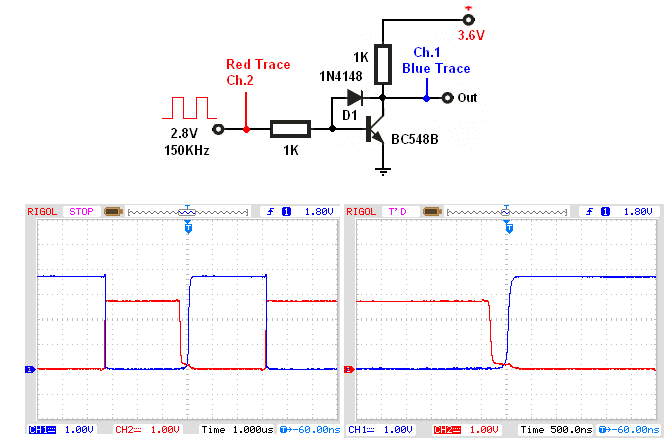

Try to add a resistor 10K between and GND and diode 1N4148 parallel to 1K resistor, diode anode toward the base.
This is called saturation recovery time. When the BJT collect/base diode turn on, it takes time to remove the charge to recover. This is the reason they came out with schottky TTL in the 70s. If you connect the cathode of the schottky diode to the base, anode to the collector. When the collector try to swing over 0.3V below the base, the schottky turn on and drag the base along so the collect/base diode never turn on. With this the recovery time is a lot faster. Try put a schottky diode like what I describe and you'll see it recover a lot faster.

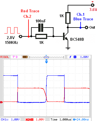

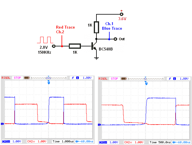

I also do some measurements of this circuit
And I get almost the same recovery time.
And the only think that helps was to add anti-saturation diode.
And speed-up capacitor help as well.

But the key is still the schottky. You put a 1N4148, that is a normal diode, it help a little, but nothing like the schottky. The cap is only secondary. You should get delay down to few nS, not close to 100nS.

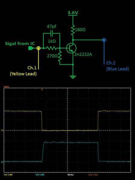

Well after working with it and suggestions from here and elsewhere. This is where I ended up.
I have the frequency back up to 750 kHz which is where I wanted it to begin with (I had slowed it down by 4x earlier)
The key that I found to decreasing the fall time was from the 2N2222A datasheet, one of the graphs buried in the datasheet talked about collector current vs. turn off time. So I put more current through the transistor when it was on, and when I turned it off it was a MUCH faster fall time. It went from 300ns fall time to 55ns fall time. So I’m happy with that so far. I will try the shottky diodes when they get here (I just hope I ordered the right kind now, I ordered "1N5819-TPCT-ND" from digikey)
Here is the print and waveform I ended up with (this waveform is at the slower frequency)
