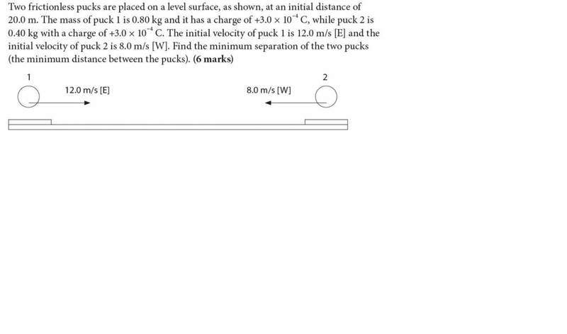

Two frictionless pucks are placed on a level surface with an initial distance of 20m. Puck 1 has a mass of 0.8 kg and a charge of + 3x10^-4 C while puck 2 has a mass of 0.4 kg and a charge of +3 x10^-4 C. The initial velocity of puck 1 is 12 m/s [E] and the initial velocity of puck 2 is 8 m/s [W]. Find the minimum separation of the two pucks (the minimum distance between the two pucks).
This is my attempt at a solution
I first used the law of conservation of momentum to find the velocity of each mass at minimum separtion. The 2 masses have the same velocity at this point.
Note: [east] is positive
Pt=Pt'
m1v1+m2(-v2)=(m1+m2)v'
isolating for v'
v'=(0.80)(12)+(0.40)(-8)/0.80+0.40
v'=5.33 m/s [east]
Next i used the law of conservation of energy:
Ek=kinetic energy
Ee=electric potential energy
Ek1+Ek2=Ee+Ek'
1/2m1v1^2 + 1/2m2(-v2^2) = kq^2/r + 1/2(m1+m2)(v')^2
inserting each value
1/2(0.80)(12)^2 + 1/2(0.40)(-8)^2 = (9.0X10^9)(+3.0X10^-4)^2/r + 1/2(0.80+0.40)(5.33)^2
isolating for r (the distance) I get:
r=15.2 m
so the minimum distance between the 2 pucks is 15.2 m
Is this correct? I am not feeling too confident with my answer of 15.2 m it just seems too big a separation. If i made a mistake or forgot to include something or included something i shouldn't have. please let me know. Also I am not sure if i am correct in assuming that there is no electric potential energy when the pucks are 20 m apart. It seems that they are too far apart to have any electric potential energy between them. Can someone confirm this with me also?

Looks dubious to me. I just glanced at the workings and it doesn't look like the electrical PE is being handled properly --- there should be contributions at both initial and final separations. And for the initial KE, why is the square of the velocity of the second puck made negative?
Perhaps you should make your own, fresh attempt.
Its negative because its traveling in the opposite direction. I've attached a picture of the situation.
Kinetic energy has no direction, it's always a positive scalar value. KE from all particles sum to a total.

You'd better confirm that. Especially since your 'final' distance of around 15m isn't significantly different. What's the PE for the initial separation?

Check the potential energy contribution and redo.
EE+EK1+EK2 = E'E+E'K
(k(3*10^-4)^2 )/20 + 0.5(0.8)(12)^2 + (0.5)(0.4)(-8)^2 = (k(3*10^-4)^2)/r +0.5(0.8)(0.4)(5.33)^2
40.5+57.6-1.6=810/r' +17.0645334
r'=10.19695653m
I was wrong about the initial electrical potential energy. I thought that at that range, its magnitude would be minuscule.

Still not quite right. Check your KE for m2. The magnitude of the value looks incorrect, and KE is never negative!
Damnit. When I wrote the calculation down on paper, I forgot to include the square on the (-8).
40.5+57.6+12.8-17.0645334=810/r'
93.8354666r'=810
r'=8.632130572m
That looks much better :smile:
Be sure to round your final results to the appropriate number of significant figures.
