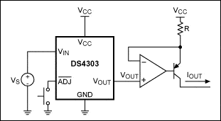

Just for speaking, what do you think about the following schematic from Maxim, which uses an op amp, a transistor, and a resistor ?
Here there is an application note for DS4303/DS4305, but I am puzzled about the ADJ procedure as well as about how the BJT can operate within its linear range...

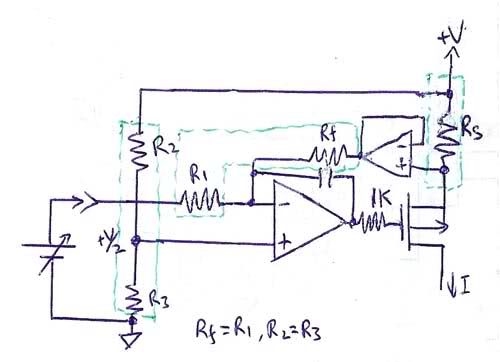

I see you need current source from the top. This is the circuit I come up really quick. Double check whether I make any mistake:
150118[/ATTACH]"]
The reason I kept pushing for MOSFET is because it does not draw any gate current and is a true current source with high output impedance. Using simulate current source implemented with a voltage source has a disadvantage of slow change with changing load impedance and is really not low impedance output.
The idea of the drawing is a differential amplifier with reference to the top sense lead of Rs. The resistor Rf and R1 should be in single match package. So is R3 and R4. I think Vishey sell these precision resistor pair specially for this. I just put the ratio of 1:1, other ratio is possible. You have to work out the detail. One issue is the +5V supply which is a little low for this circuit. It is a little low for even the other ones here!
The adjustable battery is the current control where I=V/Rs. The op-amp voltage follower is used to buffer the sense lead of the Rs so it does not draw any current by the differential amplifier. It is important to choose an op-amp with low offset voltage drift as it contribute to temp. error coef. Rf, R1, R2 and R3 should be under 10K, the capacitor should be about 200pF for stability. The 1K resistor from the output of the op-amp to the gate is to isolate the output from the gate capacitance.
Again, double check my work as I am having fun and it's your neck! :-p :smile:

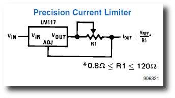

I'm sorry maxim - it's page 19 of the document which is page 20 of the PDF file.
How do you copy those drawings for posting?
Anyhow look at bottom of page with number 19 at bottom which is page 20 of pdf document, for little circuit " precision current limiter"
it's just the IC and one current measuring resistor...
i will read your 4303 datasheet and see what it is.
Basic approach is to set a reference , measure current with a precise resistor and wire an opamp to keep them equal.
Only two difficult parts are a stable resistor to measure current, and a stable reference voltage for desired current.
LM117 has a decent reference and opamp internal to it.
Interesting!
I like the MOSFET in the output stage, as well as two op-amp!
No too complicated, despite the fact the V is only 3V3 or 5V.
Iout should be 100 mA, thus using 3.3V as input voltage and Rs = 33 Ω low tolerance, I should be on the right side.
What is not clear for me is the limit of V=5V as an issue you mentioned earlier.

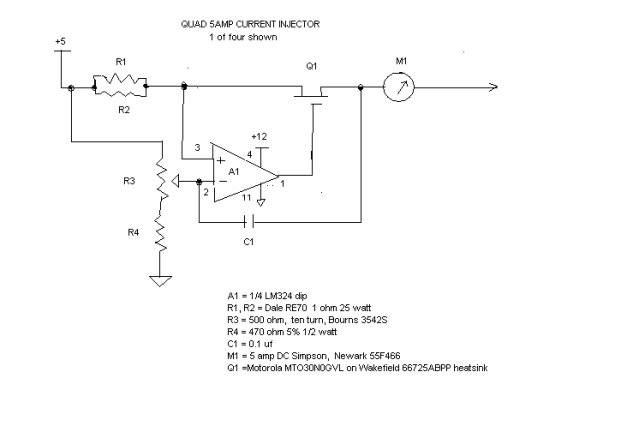

Here's a current injector i built years ago.
Yungman - Were R3 shunted with a 2 terminal reference and A1 changed to a 3 volt rail to rail amplifier, would we be there? Tweak R values of course.
This worked great with LM324 but i had to give it higher supply, it needs 1.5 volts headroom to V+ on inputs , though they'll sense down to negative rail.
So, this guy here?
Both this and my circuit use a MOSFET, I am worry about the gate voltage eat up a lot of the supply voltage. Some MOSFET need about 3V between gate and source to work, there goes 3 out of 5V! I think both work if you can get it to work for 5V supply no matter what. I think the MOSFET can be replaced with a darlington hybrid with a p-JFET and a PNP. JFET is to really lower the gate current to get more accuracy and if the drain of the FET drive the PNP base, you don't loss any current at the process. Amps are easy to find now a days. I have been designing using 6V single supply op-amp that can work down to 1.8V single rail. A lot of them are rail to rail. It is the pass transistor that I am worry about.

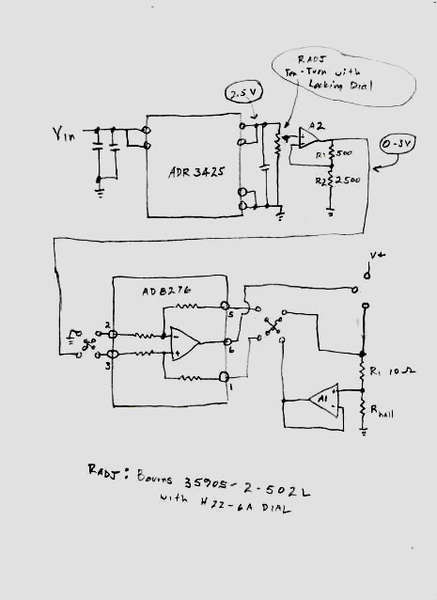

So, being inspired by your good advices, I put together the latest project.
It uses a low power Differential Amplifier (AD8276B) supplied by a Voltage Reference (ADR3425), a low bias current Op Amp (AD8603) for a feedback loop, then an external current source BJT (T1, to be defined).
http://img861.imageshack.us/img861/8749/schematicdiagramsourcec.jpg
Please, have a quick look to that and let me know if makes sense.
Later on I will write here my considerations and calculations for the component sizing, based on datasheet and app notes from Analog Devices.
Of course, any idea, suggestions or criticisms are welcome!
maxim
About the schematic above, here I have put few comments, hopefully updated by volunteers:
The AD3425 serves as voltage reference to provide a stabilized 2.5V (VREF)
The AD8276B is used here as difference amplifier, where VREF is applied to its non inverting input (+) to control the amount of output current, IO. The inverting input (-) is grounded. The output of the AD8267B is used to drive the transistor (T1 to be defined) since a current of a few hundreds of mA is required.
The AD8603 op amp is used in the feedback loop of the circuit; it has low bias current (< 1 pA), low offset voltage (< 50 μV), and low temperature drift (< 4.5 μV/°C ) .

Okay - your scheme is so good it doesn't need much change i think.
All I did was three things:
1. make Vref variable to give 0-300ma adjustment range with 10 ohm R1.
To that end,
Added Radj a ten turn pot with locking dial. That let's you set current by a ten turn dial with good resolution.
http://search.digikey.com/us/en/products/3590S-2-502L/3590S-2-502L-ND/1088592
http://search.digikey.com/us/en/products/H-22-6A/H-22-6A-ND/499307?wt.z_cat_cid=Dxn_US_US2011_Catlink
Added a buffer voltage follower amp A2 to Radj. 500 and 2500 ohm divider on output make his output 0-3 volts for 0-2.5 in. If you use instead ADR3430, omit those resistors.
A2 can be another AD8603, or half an AD8607 with other half replacing your 8603
http://www.analog.com/en/all-operat...plifiers-op-amps/ad8607/products/product.html
The buffer keeps the resistance of your potentiometer from appearimg in series with Mr8276's internal 40K resistors.
2. Added provision for "Criss-Cross" jumpers at inputs of Mr AD8276.
That let's you use either NPN or PNP driver.
Install horizontal jumpers for NPN like your 2N1711 or one of Yungman's Mosfets
Install diagonal jumpers for PNP like my TIP125.
3. Showed three dots instead of drive transistor.
Make two sets of holes on you board, one set for TIP and another for your 2N1711.
That way you can use either NPN or PNP or MOSFET driver, emitter up for PNP and emitter down for NPN.
http://s232.photobucket.com/albums/ee289/oldjimh/?action=view&current=ForMaxim1001.jpg
NOW while typing i realized that you may not need infinite adjustment.
If not, consider this:
Omit buffer and Radj, go back to 2.5 volt Vref.
Make your R1 measuring resistor be three 25 ohm resistors and a switch that let's you select one, or two or three of them in parallel. That'll give you 100, 200 or 300 ma.
And in keeping with Detecive Columbo's "One Last Thing";;
Yungman's sketch in post 10 had a capacitor to stabilize things. Always a good idea.
That additional stage behind Mr8276 increases his open loop gain , but only if we use PNP driver.
Sooo we should add a zero ohm resistor (jumper) between top of driver transistor
and Vsupply , to be replaced with just a couple ohms to reduce loop gain in case PNP exhibits instability.
Can add that to sketch.
What's your thoughts so far?
This circuit is a wonderful solution!
I will keep you informed about progress.

BTW while you're experimenting, try that LM317 circuit from post 14
1.25V/.1amp = 12.5 ohms
Right. I will try also the LM317' solution: easy and compact.
