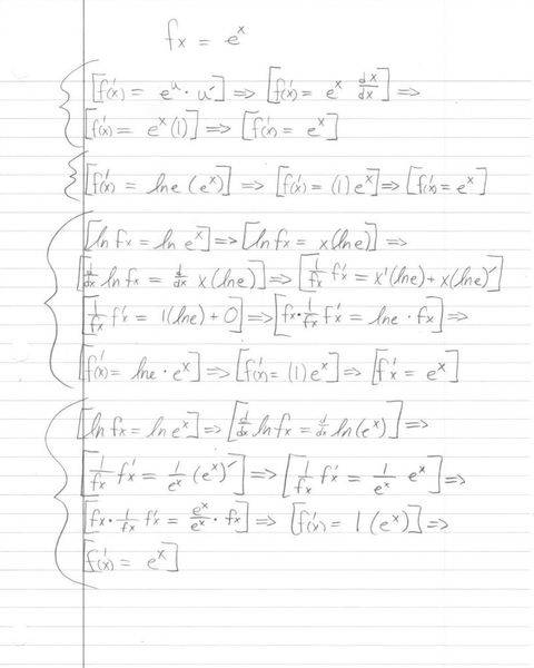

In the last couple threads, it has become apparent that I need to organize my understanding of some of the derivative rules, specifically as they relate to exponential functions, such as e^x.
So I wrote out a couple possible ways of evaluating e^x. Could you tell me if these are valid or invalid methods.
I want to say that they are all correct methods except for the last method. Even though I get the correct answer in the last (4th) attempt, it does not work for any other exponential function, thus is coincident that it works with e^x.
So basically, in terms of functions in which the variable is in the exponent, the methods of exponential rule, chain rule, or taking ln of both sides are valid. However the power rule can not be used. (and of course the inaccurate method of using the chain rule as in attempt #4 also can not be used)
Is this an accurate assessment of taking derivatives of exponential functions? Is there anything I'm missing or anything I'm mixing up?
I got to be honest with you: I have no idea what it is that you are trying to do here. One way to define the exponential function is that it is the function whose derivative is equal to itself. If the exponential function is defined in this way, then there is no point in trying to show that this result is true, because it is true by definition.
For instance, in method one, when you used the "chain rule" (which was unnecessary, because you did not have a composition of functions), you used the fact that the derivative of the exponential function is equal to itself in the calculation itself. That's how you got the eu factor. So this is completely circular and ultimately pointless.
For method 2: I have no idea what you did. It makes no sense.
Method 3 is sort of OK. Instead of starting with the definition of ex, you could very well (as an alternative) define ln(x) first as the function whose derivative is equal to 1/x. You could then define the exponential function exp(x) to be the inverse of ln(x), and then show that this inverse function must have a derivative that is equal to itself because of the definition of ln(x) above. This is essentially what you have done. However, you have a bunch of useless and extraneous steps, because you carry ln(ex) through the calculation. Since the exponential function and the natural logarithm are inverse functions, they UNDO each other. In other words ln(ex) = x. So you could have just written:[tex] f(x) = e^x [/tex][tex]\ln[f(x)] = \ln(e^x) = x[/tex][tex]\frac{d}{dx}\ln[f(x)] = \frac{dx}{dx}[/tex][tex]\frac{1}{f(x)}\frac{df}{dx} = 1 [/tex][tex]\frac{df}{dx} = f(x)[/tex]
Method 4, as far as I can see, is not any different from method 3, except for the order in which you carry out certain steps. I should point out that the step indicated by the third arrow in method 4 is totally circular as well, because you state that [itex](e^x)^\prime = e^x [/itex] which is the very result that you are trying to show.
Okay, I get what you did in method 2. You used the fact that for a general exponential function with arbitrary base a (instead of the natural base e), the derivative is given by:

You know, it's really frustrating when somebody asks me for help, and I explain to them that what they are doing has no point to it, and that it makes no sense, and I elaborate on why that is, but the person doesn't seem to listen, and just responds by trying to do more of the same misguided stuff, instead of trying to learn. It's as though that person either didn't listen, or didn't understand.
Most of your "discrepancies" arise from the fact that you simply haven't learned and undersood the rules of differential calculus at all. For example, let's take a look at your method 1. I don't know why you're trying to apply the chain rule to a function that is not a composition of more than one function. But let's say for the sake of argument that you did have a compositions of functions. You have f(u) = bu, and it turns out that the variable u is itself a function u = u(x). Therefore, you actually have a composition of functions: f(u(x)), and hence the chain rule is appropriate (in this contrived example that we just made up, NOT for bx alone). The chain rule says that:[tex]\frac{df}{dx} = \frac{df}{du}\frac{du}{dx}[/tex][tex]~~~~~= \frac{d}{du}(b^u)\frac{du}{dx}[/tex]Now at this point, the function bu is an exponential function of u. It is NOT a power law function. So WHY the heck are you using the power rule? :confused:
You would use the exponential rule just as you would for any other exponential function:[tex]\frac{df}{dx} = b^u\ln(b)\frac{du}{dx}[/tex]As you can see, the rules work just fine if you actually follow them.
For method 2: In the fourth step, ln(b) is a CONSTANT. Therefore [itex]\frac{d}{dx}(\ln b) = 0 [/itex]. The derivative of a constant is 0. There is NO POINT in writing it as b'/b and then carrying all of those useless steps through the calculation, because b' = 0.
For method 3. What do you mean "does not work?" It worked just fine. It was a bunch of useless steps that served no purpose...but it worked. At the end, you obtained:[tex]f^\prime(x) = \frac{(b^x)^\prime}{b^x}b^x[/tex]Notice that you have a bx in both numerator and denominator, and therefore they cancel, leaving[tex]f^\prime(x) = (b^x)^\prime [/tex]So what you've shown is that [itex]f^\prime(x) = f^\prime(x)[/itex]. It's certainly true, it's just not useful.

What? The power rule is NOT the same as the chain rule AT ALL. The power rule is for differentiating power law functions, and the chain rule is for differentiating compositions of functions (i.e. when you have a function of a function). Furthermore, the power rule is for power law functions, NOT exponential functions. Therefore, you should not expect it to work on ex or bx.
I think I used the chain rule ( method #1) incorrectly for the b^x function. I think I should have just kept it as b^u*u' = b^x*1 = b^x instead of ub^(u-1)*u'. That would have been more in line with how I was applying the chain rule to e^x in the original post. However, since neither the power rule nor the chain rule with u substitution will not work for b^x, it kind of doesn't matter.
To re-iterate what I said above: you WERE indeed using the chain rule wrong, but not for the reason you think. The chain rule works just fine for a composition of functions, provided you use it correctly.

That's fair enough, but it only really makes sense to use method 2 and method 3 from your original post on exponential functions. It's an exponential function, so either use the rule that applies to exponential functions, or get rid of the exponential using a ln.
Based on the kinds of mistakes you've been making in your work, I think you need to brush up on the basic differentiation rules before moving on to more advanced stuff. For example: the derivative of a constant is 0. That's a rule you ought to know and understand before continuing.

You misinterpreted what Office_Shredder said. I have put the key phrase in boldface. He was saying that after you take the natural log of both sides, then at that point you will be faced with a composition of functions, which will require you to use the chain rule. He also rightly points out that this is a waste of time and it is better to just differentiate s(t) directly, instead of taking the ln of both sides, which only introduces more work for you once you do end up differentiating.

You can apply the chain rule to bx and I've just shown you how to do so above. It just doesn't help you at all, since you still need to know the exponential rule to compute the derivative of what you end up with. Like I said, it doesn't gain you anything.
LearninDaMath said:
And the chain rule does not work on b^2x (only the exponential rule would work).
Yes, it does work, and in this case, it is required in order to do the derivative correctly.

Once again, you're simply doing it wrong. It seems like you don't know how to apply the chain rule properly. If f(x) = b2x, then you can say, let u(x) = 2x, then f(u) = bu. This is a composition of functions (I could have written that explicitly as f(u(x)) = bu(x)). So, the chain rule says that
[tex]\frac{df}{dx} = \frac{df}{du}\frac{du}{dx}[/tex][tex]~~~~~=\frac{d}{du}(b^u)\frac{d}{dx}(2x)[/tex][tex]~~~~~=b^u\ln(b)(2)[/tex][tex]~~~~~=2b^{2x}\ln(b)[/tex]
