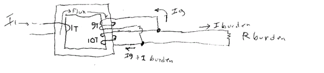

I can't say i understand the nine/ten turn bifilar winding.
Initial reaction is that gave them nine and a half turns, leaving a half turn of primary current to account for magnetizing current of core. But i want to do some reading.

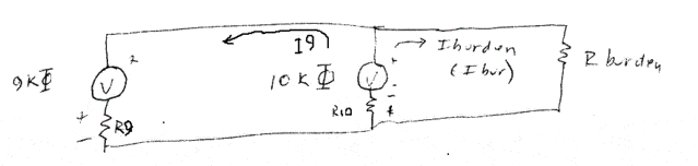

You can bet they did, and bigger mystery is unequal numbers of turns.
Thinking aloud - parallel windings of unequal turns will circulate current
and the circulating current will oppose flux in one winding but aid it in the other.
Amount of circulating current will be (volts mismatch)/ohms
and (volts mismatch) is in proportion to flux so will be a measure of the error in transformer's current ratio.
perhaps they got clever and linearized the transformer? Or just accounted for magnetizing amp- turns? I suspect the latter.
Those windings were both wrapped same direction around core, right?

What do you know - that transformer was designed !

Could that have been two nine turn windings? It's easy to lose track of one at the terminals..
I go with jim.
The voltage difference is like 10%.
When the regular CT is open circuited, very high Voltage can get induced.
But in this CT, when the secondary is open circuited, Let the voltage induced in the coils be 10V and 9V. Now, the circulating current I = (10V-9V)/R
Now the circuilating current flows in both windings, but the Amp-turns cancel each-other.
Hence net Amp-turns = (10-9)*I = V/R
This amp-turns must equal primary Amp-turns = I_primary
hence, I_primary = V/R
hence, V = I_primary*R
Hence, there is limit to what the open-ckt terminal voltage of the CT will be.

and please bear with me.. Since DCCAD no longer runs under windows i am without drawing program.
I did my best to figure out that current transformer without going into heavy duty math. It'll probably take me three posts. I type as slow as i think.
Here goes:
Here's a sketch of current transformer.
Let ## flux = ## [itex]\Phi[/itex]
## \Phi = \frac {\sum amp-turns } {Reluctance} ##
note with assumed directions, primary amp-turns are aided by upper secondary and opposed by lower one.
## \Phi = \frac{I1 + 9I9 -10(I9 + Ibur) }{Reluctance} ## (oops i shortened Iburden to Ibur )
## \Phi = \frac{I1 -I9 -10Ibur}{Reluctance} ## ; EQ 1.
We will look again at reluctance soon enough.
Now let's try a loop current method on the electrical circuit and see if anything fortuitous happens.
Here it is.
Each secondary is represented as an ideal voltage source in series with the resistance of its winding.
Value of voltage source is K X [itex]\Phi[/itex]
I know, it has to be d[itex]\Phi[/itex]/dt but remember we're dealing with sine waves.
So there's a 60 hz sinewave flux of RMS amplitude [itex]\Phi[/itex] that produces 377 volts/weber in every turn.
For this little core we should probably be talking microwebers and millivolts.
For now let constant K include all the multipliers for core area, permeability, and the 377 that results when we differentiate a 60 hz sinewave ( 377 = 2∏X60 ) .
So, for flux ## \Phi Sin(wt)## we get voltage ## K\Phi Cos(wt) ## in each turn.
## Ibur Rbur = 10K\Phi - R10(I9+Ibur) ##
and
## Ibur Rbur = 9K\Phi + I9R9 ##
Subtracting,
## 0 = K\Phi - I9(R10+R9) - R10Ibur ##
## K\Phi = I9(R10+R9) + R10Ibur ##
## \Phi = \frac{I9(R10+R9) + R10Ibur} {K}## ; EQ 2
I think we're almost there, fellows.
Now we have two different equations for flux.
Set ## EQ 1 = EQ 2 ##
## \frac{I1 -I9 -10Ibur}{Reluctance} = \frac{I9(R10+R9) + R10Ibur} {K}##
Now let us set ## I1 = 10Ibur ##
because that's the objective of this whole experiment (well, really for me it's to understand this current transformer better).
## \frac{10Ibur -I9 -10Ibur}{Reluctance} = \frac{I9(R10+R9) + R10Ibur} {K}##
## \frac{ -I9 }{Reluctance} = \frac{I9(R10+R9) + R10Ibur} {K}##
## \frac{ -I9 }{Reluctance} = \frac{I9 R9}{K} + \frac{I9 R10}{K} +\frac{Ibur R10}{K} ##
## \frac{Ibur R10}{K} = -\frac{ -I9 }{Reluctance} -\frac{I9 R9}{K} - \frac{I9 R10}{K} ##
## \frac{Ibur R10}{K} = -I9 (\frac{ 1 }{Reluctance} +\frac{ R9 +R10}{K} ) ##
## Ibur R10 = -I9 (\frac{ K }{Reluctance} + R9 +R10 ) ##
## -I9 = \frac{Ibur R10} { R9 +R10+\frac{ K }{Reluctance} } ## ;; EQ 3
My negative I9 means i assumed it in wrong direction which you probably remember from early posts.
R9 and R10 we can measure if Mr Tinkeringone still has some of the wire.
##\frac {K}{Reluctance} ## is going to be (milli)volts per turn per amp-turn of magnetizing current, which we can measure and plot from the sixty watt lightbulb test.
Then i think we'll have this transformer characterized.
We can easily calculate how the load current is shared between secondaries.
I'll be iterested to see how sensitive it is to the resistance of the wire in secondaries.
I feel inadequate that i can't get here via Maxwell's equations.
BUT to have got all this typed is a milestone for me - first time Latex experimenter.
If you find any errors of thought or of transcription, please advise.
I'm pooped. See you later
Improvements and correct are welcome,
respectfully submitted,
old jim
