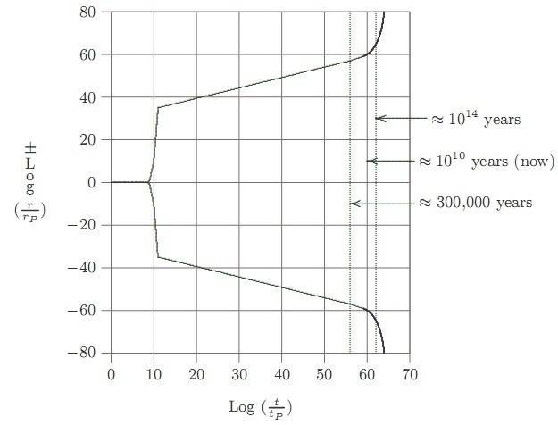

I agree with what you wrote. Just another (possible) misunderstanding of what happens at the end of inflation, probably because of the use of certain words, i.e. (from your page):
"EXPANSION --- After inflation, the universe settled down to a more sedate rate of expansion, something like a ballistic affect from the inflation."
This is correct, but it creates the impression that there is a sudden change in the expansion rate (da/dt) after inflation, an impression also enhanced by the usual log-log type graphs used to fit the enormous range onto one graph (see the attached graph example).
Does the 'ballistic effect' and mutual gravity not make the expansion rate smoothly change from that extreme 'end-of-inflation' value to the 'sedate' values that we observe today?
Log-log graphs normally show that as a sharp change in slope, but it represents a sharp change in the extreme acceleration rate during inflation to the steady deceleration after inflation - not a sharp change in expansion rate. My example graph's slope is 1/2 after inflation (radiation dominated), changing to 2/3 (matter dominated) around 100,000 years and will in the far future again increase steadily (dark energy dominated). My timescale (t/t_p) is plotted relative to Planck time and the size scale (r/r_p) is roughly Hubble radius at time t relative to Planck scale.
Thanks for that. I'll look into it and make sure I understand it myself and then update the page.
