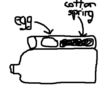

So my biggest concern at the moment is the egg, in terms of resisting impact force, I am adding a giant crumple zone as the nose of the rocket. Does anyone have any experience with protecting eggs from impact. I considered perhaps putting the egg in some sort of light weight jelly. Is that a good idea?
Another idea I had was a sort of cotton spring
the picture should be attached.
is this flawed? I'm sort of thinking that it wouldn't be effective because the egg's weight in the back would cause the rocket to dip backwards, and if it lands on its back then the egg will have no protection.

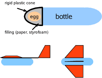

You can cut off one half of a second bottle for the egg, fill with paper/styrofoam, and duct tape it to the front of your rocket:
As for the airfoils, two different glider configs are shown at the bottom. But K^2 might be right that pure ballistic flight with a small fin behind the nozzle is better.
I am a little concerned about putting the egg on the front of the rocket to be honest.

If you put the egg above the rocket like in your image, your center of mass is not aligned with the thrust, and your rocket will fly some uncontrollable curve.
A second structure below could balance that, but it would increase the mass a lot and it would be hard to do it properly.
