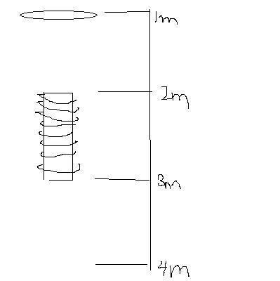

A 0.5m diameter aluminium plate moves downward at 0.1m/s along the axis of a 1m long solenoid proving a magnetic field of 3T at the centre. The plate moves from position 1m above the solenoid and move down to a position 1m below the solenoid. The way it moves is described in the attachment Solenoid.jpg.
First of all is it even possible to find the induced emf in the plate without some really complex (and by complex i mean beyond 2nd year university level) ?? BEcause every question asks for sketch i am guessing that i don't need numbers involved in this

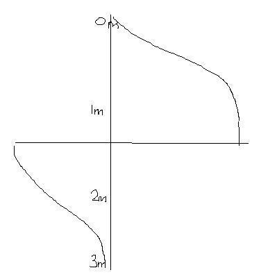

Sketch a graph of the EMF induced in the plate as a function of vertical position
The EMF would be constantly increasing positively as the plate approaches the solenoid from the top, and then while in the solenoid, the emf would be increasing as well and then go to new negative minimum after the plate passed the mid point of the solenoid and then gradually increase?

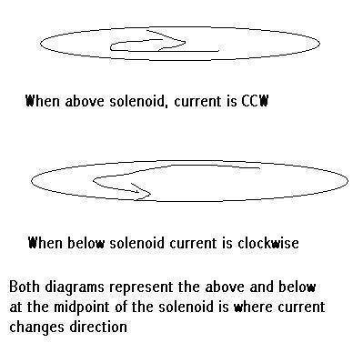

Sketch how the current flows in the plate.
Eddy currents are the currents within the plate, yes? SO the currents would be circulating parallel to it's circumference?
Increasing: yes, constantly: No, indeed, it increases quite complicated...
if you assume the field is constant along the solenoid, why would the EMF increase as the ring passes its. EMF generates only if there is a CHANGE in magnetic field. Sure, in real life, the field along the solenoid is not constant, however, it is very close, and your assumetion is completely valid.
beware of your direction... is the direction of your EMF same b4 and after passing the mid point. why or why not?
basically, you are right. What about the direction?.. would the current flows Clockwise or CCW? would the direction changes when passing thru the solenoid?

i hope the answers i have posted are correct, please tell me if i made any errors
here are the two other ones
In both of these where there is an axis i have taken the right as positive and left and negative the horizontal solid line repsents the midpoint of the solenoid
