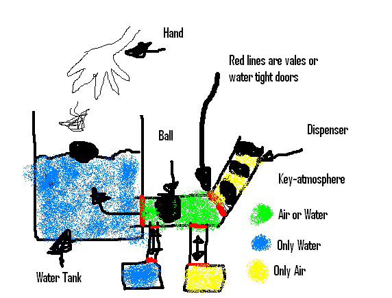

Hello, I am 17 years old and studying Mechanical engineering an i started thinking of creating some sort of game ( a bit boring) where children have to grab different coloured balls from a tank of water, i was wondering how to create a dispensing system to allow balls from a dispenser in which they are in air, to be inputed by gravity, into a container which can be filled with air or water, once filled with water, a door leading to a water tank will be opened and the ball will rise to the top of the open tank to be picked out of.
(picture Attached) Sorry for the poor quality, but it should help convey my message.
This multi atmosphere container, atmosphere will be changed by two other smaller contanairs equal or grater than the 2- way container, which one will hold air and the other will hold water. These will hydraulicly suck or fill this 2- atmosphere container, with eaither water or air depending on whether the ball is ready to be dispensed or resetting the system.
At the start the 2-A-container, will be filled with air to allow the ball to go in it. Then the door conecting to the dispenser will close. Then teh container filled with water, will fill the 2-A-C with water, therefore the other container will be holding this air. Then the door conecting to the main tank will be opened and the ball released to the tank and will float to the surface.
Then the door will close. The container which recently held the water in it and now empty, will then suck the water out of the 2-A-C and return it full of air for the process to repeat.
I would prefer all the mechanisms to be electrical from the , dispenser, doors, and containers which suck and input the air/water into the 2-A-C
What I am asking for is, to tell me whether or not this will work, limitations in this design and any improvments or alternatives.
Thanks for reading, and i will be gratful for any comments.

Don't see why it wouldn't work. With fine tuning and the right parts it looks like fun for the younsters.
I see only one potential hang-up, being that there doesn't seem to be any incentive for the ball to enter the tank. That would easily be solved by angling the "airlock" tube slightly upward so buoyancy would take effect.
Wouldn't water trying to level (height) both inside the tank and the dispenser be a problem?
My gut tells me this might be over-engineered. The reason it's only my gut is because I can't tell how much you actually need and how much you presume to need.
So my question is: separate from the way you've devised it to happen, what parts need to happen?
For example, is it necessary to artificially keep the container with the balls in it air-filled? If the ball-filled container were above the water-level, the container will remain air-filled by itself.
I think I see the problem you are trying to solve, which is that if the balls float in water, they would also float in the dispenser if everything was full of water. So the balls woudn't get into the tank.
On the other hand, a piston or plunger to push the balls down the dispenser tube so they pop into the tank one a time seems a much simpler idea.

Thanks for replying, that was only really a rough sketch but that what i was sort of going for.

Thanks for reply but I was trying to show that the dispenser was fulled with air, as i attempted to show in the diagram. Thats why the Valve that changes its atmosphere was so important to help it fall in,then sealed off.

The ball container(dispenser) full of air, will be in a separate tank than the water, meaning it is not surrounded by water so it could be open to for easy topping up of balls. Its just the valves and the method of inputing the balls in the bottom of the tank without manually doing so, that's why i was trying to create a hydraulic system to take away and fill the middle chamber (inbetween the dispenser and water tank) with water. To enable a easy wat to make sure the ball will rise from the bottom of the tank, to stop hands getting wet.
So, does anybody have any better ways to dispense the ball in the tank?

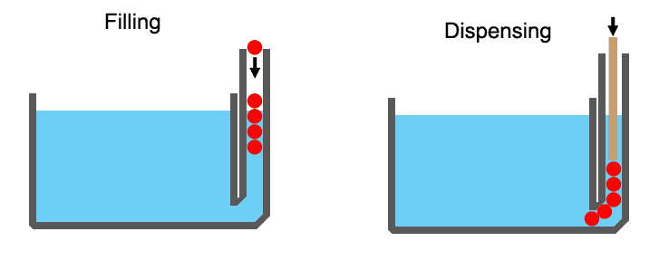

Iy needs to be bigger for more than one person, but this will need supervison. A paddling pool can be just as dangerous. However I am concered about the mechanisms, so can you help me improve the mechanisms?
What is wrong with something as simple as a tube/hopper slightly wider than the balls, and a stick of wood to push them down the tube?
You could tilt the tube (delivery system) over 45 degrees so that the end of the tube (hopper) is far way from the watertub (game zone) and it would still work. A quick shove of the stick (dispenser apparatus) would eject a ball into the game zone.
I believe that could work quiete well. Thanks you for spending time to make that diagram.
