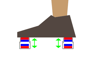

Hello,
I am new to the forums, my name is Brandon. I have just recently graduated high school. I graduated from my physics class with a 97% for the year! yay!
But off to my question...
I have been thinking of a cool project that involved 4 neodymium magnets and using the repulsion force between them to act like a "spring" effect to make you able to jump and run at increased increments.
Here is how it works:
You have two magnets for each shoe. You contain the two magnets inside a non-magnetic material so the axis are lined perfectly underneath the shoe. I am not sure of the complete contraption yet but I was thinking if you used magnetic repulsion it should act like spring shoes, well... my theory anyways. Could this possibly work?
Thanks for the help. And hello again.
Brandon
Then why not just use springs? The only advantage I see is that springs may fail earlier due to wear.
I just do not see springs being stronger than some magnetic repulsion.
Hi physicsfrenzy. Yes, it will work, though the efficiency gain may not be as spectacular as you hope. One thing you may not have considered is the gradual loss of magnetism of the ground-contacting magnets due to the shock of hitting the ground hard with each step; a rubber sole should go a long way to easing that. I can see that a well-designed containment box will be essential. :wink:
You may find that best efficiency is associated with a kangaroo-bound gait, keeping feet together throughout. Some adaptation of ski poles might reassure the beginner. The extra weight compared with spring shoes will help develop good calf muscles!
Good luck with your physics career. :smile:

To get this to work - even in principle - here's what you'd need to do:
1] Arrange the magnets on your feet so that they are all pointing the same direction - say, south poles downward (or even more simply, one large sole-shaped magnet).
2] Arrange magnets in the floor so they are all pointing with south poles upward.
Now your shoes will be repelled from the floor.
In theory, this would provide a springlike effect. If you jumped off a chair onto the floor, the magnets would repel and bounce you back up like a pogo stick.
Unfortunately, in practice, there are several problems:
1] You could only do it in a controlled environment where you could line the floor with magnets. and you cannot simply space them out. The field must be uniform. You'd have to line every inch of the floor with magnets.
2] It would be impossible to stand upright, let alone jump, let alone run. It is equivalent to trying to stand upright in a swimming pool by strapping a beachball or floaty noodle to each foot. I've tried it. It's impossible. But it's a lot of fun to try.
3] The magnets would try very hard to flip over. You would almost certainly sprain both ankles.
While it would not be of practical use, it could be a fun amusement setup. But you would absolutely have to wear full padding and a helmet.

You said "You have two magnets for each shoe. You contain the two magnets inside a non-magnetic material so the axis are lined perfectly underneath the shoe."
Now it sounds to me like you are having two magnets oppositely aligned in each shoe and trying to use the magnetic repulsion of the two magnets in the shoe to act on the body as a whole. Everyone else is talking about a situation in which there are magnets in the shoes acting against magnets in the floor. If that is what you intended please say so.
HallsofIvy said:
That is one consequence of "conservation of momentum". It is NOT "conservation of momentum" itself. "Conservation of momentum" says that the momentum of a system cannot be changed except by an external force. What external force is acting on you here?
Ohhhhh! I see now!
All he's doing is making magnetic springs. The shoes will have a form of piston, two pistons per shoes. Each piston contains two magnets, opposing each other.
If he jumps up and down, the springs will conserve his momentum - exactly as if he were wearing coil springs on his feet.

Thank you! You explained my scenario very well. The "container" would have to be a sturdy non magnetic material to contain the magnets in a straight axis to get the most out of levitation. Basically it needs a very strong base and sides to contain those magnets or I got a feeling it would be dangerous.
And Dave,
That is exactly what I mean! I would like to do that. Would it be possible?

physicsfrenzy! So sorry I misread your original post and misunderstood your plan. Finally I get your idea. Congratulations on your novel idea...hope you continue onwards. Some of mankind's best ideas come in our earlier years! Hope you are keeping a notebook!

I did though do an experiment just now, with some 200 gram, 1970's era speaker magnets. I discovered that they were so weak, that when I placed one above the other, gravity won.
I did another experiment where my neodymiums floated in a plastic tube about 4 cm above the speaker magnets. I used a bamboo skewer to push the neo's down towards the speaker magnet. At around 5 millimeters, the repulsion was lost, and the neo's slammed into the speaker magnet.
hmmm... This is starting to look ugly on the human mass jumping shoe scale. And that's just the thoughts in my head. Just imagine what happens when you do the math.
hmmm... I wonder if Phil Knight had to put up with this negativity when he developed his air sole technology.
physicsfrenzy said:
Its been over a year since I had thought of this idea and I had to revive this old topic to generate new discussion on my shoes. (no pun intended)
The reason why I revived this topic is now I have money to invest in a prototype pair to see if they do in fact work, and how the best effective way of doing so.

to those talking about the law of conservation of momentum , its true that the momentum is conserved , but he is using magnets in the shoes to transfer his downward momentum into an upward momentum
instead of pushing on Earth and pushing it down , the magnets will push him up with that same momentum . just like a spring .
  • #33
OmCheeto said:
Someone suggested earlier that it would be just like springs. I think it would be a bit different, as springs are linear, and magnets are not, in their force vs distance equations:
Many shoes have air cushions which are also non linear. The only difference from using magnets is that the shoes will be very heavy, and jumping will be no fun at all.
