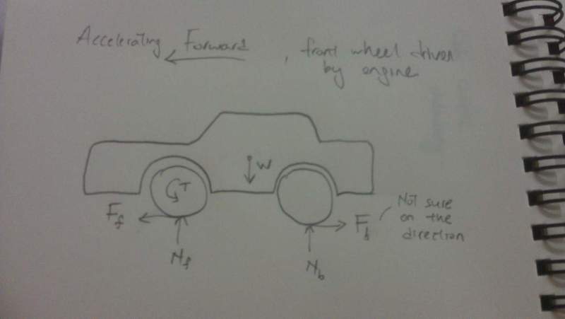

Hi everyone, good day.
when a car is moving (accelerating), what are the forces that actually acted on the car?
Is it possible to draw a free body diagram to illustrate the idea? (please draw one for me, i really need this in order to understand)
I am having problem in relating how the engine torque causing the car to move forward. i mean i can totally understand how engine convert chemical energy in petroleum to rotating output shaft, and how output shaft goes through gearing to the wheel (i understand the physical mechanism). but i failed to draw a free body diagram to analyze the system.
Also, i am quite confuse in the direction of friction acting on the car wheels. Say, the car is front wheel driven by engine, i heard people saying the friction force is the same direction as the car's forward motion on the front wheel (driven by engine), while is in the opposite direction with the car's forward motion on the back wheel (non driven wheel). is this true? if it is, can you please explain to me why it is so?
Thanks a lot for you reply!

Hi, russ_watters, thanks for the reply.
attached is the fbd i tried. please comment on it. Thank you!
F_f = friction act on front wheel
F_b = friction act on rear wheel
N_f = normal force act on front wheel
N_b = normal force act on rear wheel
w = weight of the car
T = torque from the engine acted on front wheel

What is your F_b force acting horizontally on the rear wheel? Aditionally, do you want to take into account wind resistance?
Look at the theory at the bottom of this page (Theory »» Longitudinal acceleration).

Hi, Mech_Engineer, no, i do not want to include wind resistance. the F_b is the friction acted on rear wheel.
Hi, DaveC426913, the front wheel will skid on that frictionless surface, same direction with the torque.
while for rear wheel, in my opinion, since there is no torque acted on them, they will not rotate. Am i right? that will be for the case of frictionless surface, i failed to extend the idea to the surface with friction, can you please give me more hints?
