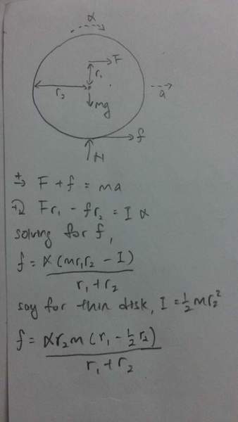

the second question is, in the case of accelerating or decelerating, does the friction act on the wheel causes loss? i mean does this friction affect fuel efficiency?
the third question is, looking at the attachment, it is found that if r1 = 0.5r2, then the friction force will be zero, if r1 > 0.5r2, the friction is in the direction as drawn in fbd, if r1 < 0.5r2, the friction is opposite to the direction as drawn. what does zero friction indicates? why zero friction still allows the wheel to accelerate? other than that, what does different friction direction indicate?
Your question comes from the fact that you are mixing 2 types of problem together. The problem you present here is for a rope that pulls a spool. You are looking for answers for a wheel driven by a torque.
In the problem presented, the pulling force creates the friction and the acceleration, one can exist without the other as even if the friction is not present, the rope will still pull the spool.
On a car, the torque creates the friction, the friction creates the acceleration. There are no other linear force acting on the car. If the friction is not present, there will be no acceleration.
So, in you attached calculations, there shouldn't be a force F, but a torque T instead. Your equations become:

If it is really a spool pulled by a rope, for r1 > 0.5r2, the spool will roll, while for r1 < 0.5r2, the spool will slide right?
I haven't checked the math for this particular problem (and I'm too tired to do it), but it is a possibility.
