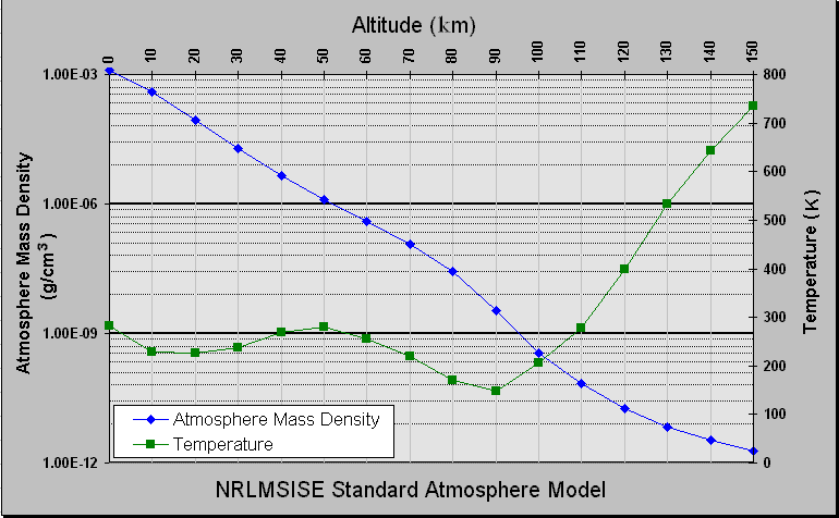

There is one thing i don't get though leakage from the surface because the higher up you get in the troposphere the colder the temperature gets so i would think like 99% of the water vapor would sink back due to colder temps and less heat excitement of molecules That basically what I am confused about but i totally get leakage in the upper atmosphere.
Temperature does drop with height in the region familiar to us (up to 10 km), but this trend doesn't continue indefinitely. Once you get above 100 km, the temperature begins to climb in earnest due to the absorption of hard UV light (which is why we don't get any of that down here).
Whether 99% of the water vapour sinks back isn't the issue at all. Sinking or no sinking, 99% of the atmosphere are close to the planet's surface, simply because density decreases with height. The issue is what happens to the 1% above that. If there is a mechanism which allows this fraction to rapidly escape, then another 1% of the remainder will have to rise to take its place, which will escape by the same mechanism, and so on until there is nothing left. One hundred times "rapidly" is still pretty rapid, if you see what I mean. :smile:
Anyway, I'm not sure I understand your thinking here. Why should water vapour sink down due to temperature decreasing with height? The decrease affects all gases, not just water, and since they can't all sink at the same time, none of them can sink at all, it seems to me. Obviously, if the water vapour gets the chance to precipitate into droplets, this no longer applies and it falls (as rain) rather than sink - maybe that's what you meant?

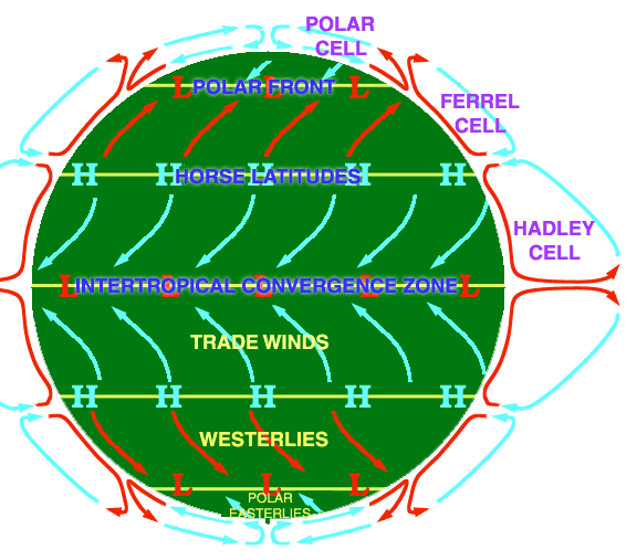

Best guess, your planet would have a single atmospheric circulation cell per hemisphere, instead of the terrestrial three shown below:
It has to be an odd number, and as your planet is significantly smaller than Earth, and as the size of such cells tends to increase with both mean absolute temperature and mean rate of change of temperature with latitudinal distance, one cell seems like the obvious choice.
The result is pretty boring, unfortunately. There'd be a cold Northeasterly everywhere in the Northern hemisphere and a cold Southeasterly everywhere in the Southern hemisphere, without any of the transient high and low pressure systems which give us the unpredictable changes most of us mean when we talk of "weather". The only variations would be seasonal ones, see above, and daily ones due to the day-night cycle. Nothing in-between.
Further, this would constitute a far more efficient mechanism of latitudinal heat transfer than what we have on Earth, so you probably wouldn't get any ice-caps at the poles. If there's land there, it'll be cold desert, if there's water, it'll just be cold. The mid-latitudes should be drier than ours, generally speaking, and should directly give way to the tropics, without an intervening desert belt.
