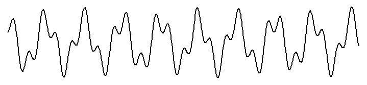

See Feynman Vol I 21-4.
I'm open to the possibility that my code sucks. If anybody can show an error in my model that accounts for the non-cosine result, please let me know. Here's what I ran:
Code:
v = 0;
x = 1.5;
a = 0;
t = 0;
dt = .0005;
c = 3;
w = \[Pi];
m = .2;
k = .135 w^2 m;
V[v_, a_, dt_] := v + a dt
X[x_, v_, dt_] := x + v dt
F[t_, w_, c_] := c Cos[w t]
f[x_, k_] := -x k
A[x_, k_, t_, w_, c_, m_] := (F[t, w, c] + f[x, k])/m
pts = {};
For[i = 0, i <= 100000, i++,
 a = A[x, k, t, w, c, m];
 v0 = v;
 v = V[v, a, dt];
 x = X[x, (v + v0)/2, dt];
 If[0 == Mod[i, 100], pts = Append[pts, {t, x}]];
 t += dt;
Graphics[Line[pts]]
This is the result:
I might do well to increase the precision of the calculations, but I doubt it will significantly alter the result.
If I understand your code right, it solves in a simple way the ODE of an undamped oscillator
[tex]m \ddot{x}+k x=C \cos(\omega t).[/tex]
This is precisely the case, I've treated in my previous posting. Just rewrite it a bit, and with
[tex]\omega_0=\sqrt{\frac{k}{m}},\quad c=\frac{C}{m}[/tex]
the equation reads
[tex]\ddot{x} + \omega_0^2 x=c \cos(\omega t).[/tex]
Then according to my corrected Green's function (I had a sign error in the final result) you get for a particular solution of the inhomogeneous equation, with homgeneous boundary conditions
[tex]x^{(i)}(t)=\frac{c}{\omega_0} \int_0^{t} \mathrm{d} t' \sin[\omega_0 (t-t')] \cos(\omega t')=\frac{c}{\omega_0^2-\omega^2} [\cos(\omega t)-\cos(\omega_0 t)].
[/tex]
Now you want to fulfill the initial conditions [itex]x(0)=x_0, \quad \dot{x}(0)=0[/itex]. Obviously you have to add the corresponding solution with these boundary conditions of the homogeneous equations to it:
[tex]x^{(h)}(t)=x_0 \cos(\omega_0 t).[/tex]
So your solution is
[tex]x(t)=x_0 \cos(\omega_0 t) + \frac{c}{\omega_0^2-\omega^2} [\cos(\omega t)-\cos(\omega_0 t)].
[/tex]
Plotting this with the values from your program (I used Mathematica) shows that your numerical result seems to be pretty accurate. :smile:

I put in a damping term, and it does seem (upon first trying,) to stabilize into a cosine wave. But that begs the question. What does a solution mean, if nature doesn't conform to it?

That's interesting. I have to admit, I don't fully understand it. I'm sure I will have to learn about Green's function if I am to understand more advanced physics. That probably won't happen this weekend.
Why should I initialize x to zero? It seems that xo could be an arbitrary displacement, and still solve the original ODE.

The idea was to first solve the inhomogeneous equation (i.e., the one with the external force acting) with homogeneous initial conditions [itex]x(0)=\dot{x}(0)[/itex] and then to add a solution of the homogeneous equation (i.e., without the external force) with the initial conditions given in your code. Of course you can solve the equation (also with your code numerically by the way) with arbitrary initial conditions [itex]x(0)=x_0[/itex] and [itex]\dot{x}(0)=v_0[/itex]. This most general solution then obviously reads
[tex]x(t)=\frac{c}{\omega_0^2-\omega^2}[\cos(\omega t)-\cos(\omega_0 t)] + x_0 \cos(\omega t) + \frac{v_0}{\omega_0} \sin(\omega_0 t).[/tex]
