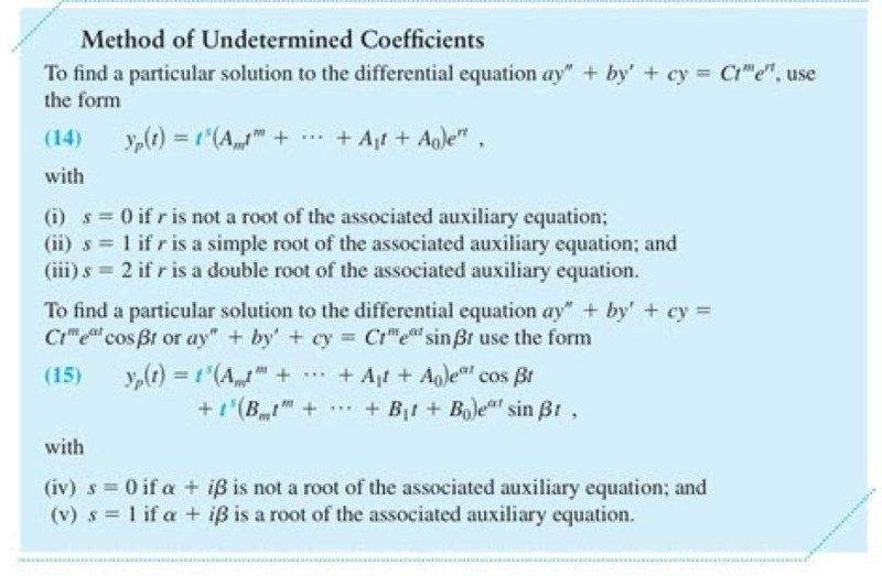

The general solution can be written as the sum of the general solution of the homogeneous equation and a particular solution yp of the inhomogeneous equation: x(t)=Acos(wt)+Bsin(wt)+yp. You can find the attachment useful to find a particular solution.
ehild
