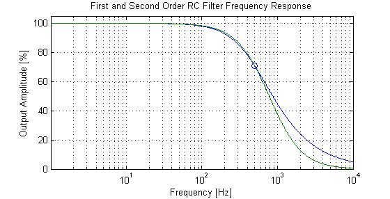

I'm trying to use a second order passive RC filter to attenuate noise in a thermocouple signal. I've heard that using two passive RC filters in series can generate "loading" effects. I'm not sure exactly what this means, except for the output response is different from the theoretical response.
Here is my theoretical response for a 500Hz cutoff frequency:
What effects does loading have on the output response and how can I combat them?

To get an ideal frequency response from two cascaded 1st order filters, you need a buffer stage between them with an infinite input impedance and a zero output impedance. Does it make more sense now?
Yes, like Berkeman said, if you don't have a buffer to isolate the two stages, they interact with each other and have a different response. I notice your frequency is quite low, My suggestion is looking into active low pass filter. Here are two articles:

To minimize loading effects, you should give the first stage a low impedance, and the second stage a high impedance.
e.g., if the first low pass stage comprises R kΩ + C μF, make the second stage 100·R kΩ + 0.01·C μF.
Other considerations, however, generally make this simple method impracticable, and you have to implement buffering.

Can anyone clarify the means that cause the response change?
Also, how does the response change? Does filtering become more aggressive, less aggressive, or just different?

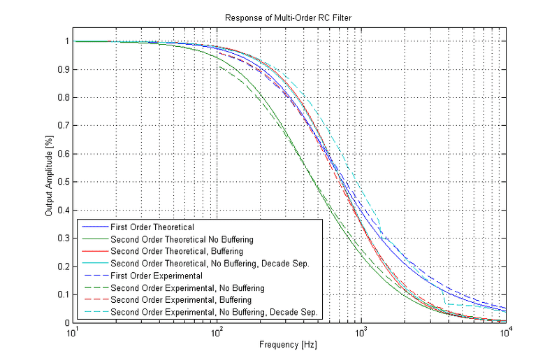

Regardless, I did go back and rederive the transfer function using KCL. Kirchoff's current law adds the additional loading term into the equation. Based on my limited understanding, it seems as if the "loading" term is caused by two things: the phase shift of the circuit and the extra current being pulled through the first stage resistor by the second stage filter. Does that sound right?
Here's a plot of my model and my experimental data (I did build the circuits on a breadboard):
For whatever reason, the bode analyzer I used generated some funky numbers on the second order filter with no buffering and the decade separation. The dashed teal line shows this (discontinuities).
The buffered response was rather disappointing. I used a 741 Op-Amp Voltage Follower to separate the two and it did get marginally better response, but only below the cutoff frequency. The corner didn't appear to get any sharper (in contrast with the theoretical model).

Yes, I did run the experiment again with the separated resistance and capacitance values. The experimental results showed a second order corner, but was marginally worse than the first order filter. I'm assuming this is because of poor component quality, but perhaps there is something else I am missing.
The theoretical response matched the buffered response almost perfectly, which I find very interesting.

"high" as in "won't measurably load the preceding filter stage"? Then that's good!
Should I surmise that your green plots are of two identical stages, cascaded? Looks like you should now be able to come up with something satisfactory for filtering those high frequencies.

Yes, I suppose I did not explain this very well. The first order filter uses a nominally 0.1uF capacitor and a 3.3kΩ resistor. The second order filters used the same 0.1uF capacitors, but with a 2kΩ resistors. For the decade separation filter, the same 2kΩ resistor was used, but the second stages used a 20kΩ resistor with a 0.01uF capacitor. The models used the measured values for resistance and capacitance.
