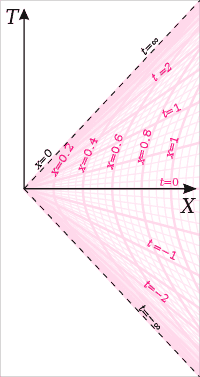

The problem is that you can only use your own clock to measure things that happen right next to you. To measure things a distance away from you, you have to invent a definition of simultaneity and maybe use someone else's clock that has been synchronised using your definition. Some events may lie outside the region you have chosen to apply your definition. Does this mean those events don't exist?
Consider the following example from special relativity. A ("Born rigid") rocket has constant proper acceleration in empty space, far from any gravity. At any instant in time, you can define distance and simultaneity according to an inertial observer who is momentarily at rest relative to the rocket. You can "glue" all these observers together to form a valid coordinate system ("Rindler coordinates") for the rocket. Here's a spacetime diagram showing the distance X and time T of an inertial frame, and the pink grid lines show the rocket's Rindler coordinates x and t. The curved line x=1 represents one point on the rocket.
Dr Greg, Wikimedia Commons, CC BY-SA 3.0
The white area above this chart is not covered by the pink grid. Even after waiting an infinite time t, none of the events in that area become simultaneous with an event on the rocket as measured by the rocket. Yet these events do have a finite inertial T coordinate. Would you say that the events in those areas "do not exist"?

...none of the events in that area become simultaneous with an event on the rocket as measured by the rocket. Yet these events do have a finite inertial T coordinate. Would you say that the events in those areas "do not exist"?
You have outlined the situation quite well. Then the question is, when, by our own clock, does the event happen?
I feel the event I am talking about (matter crossing EH) is always in the future, getting asymptotically closer to the EH, but never reaching it. Yes, by our own clock, and my question is based on our own clock (can black hole EH grow for external observers?).
I understand that the event may actually happen for an observer falling into the black hole, but by our clock, this falling observer also never reaches the event horizon! So I stand by the statement that the event "does not exist" or come to pass ever, by our clock.
This is where I see a conflict. From our point of view, drawing a geometric parallel, two lines are asymptotic and only meet at infinity, and never cross over. For the observer falling into the BH, not only do the two lines meet, but they even cross over.
