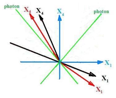

In summary: The different colors show which frame of reference the rocket is in (red, blue, black), with the X1 axes showing the direction the signal is coming from. Notice that the red and blue rockets are going in opposite directions, and that the red rocket is going faster than the blue rocket. If you think about it, this shouldn't be a surprise- the red rocket is moving away from the space station, while the blue rocket is moving towards the space station. The relativistic velocity addition law, which is a consequence of the Lorentz transformation formulas, says that the velocities of two objects are not added together

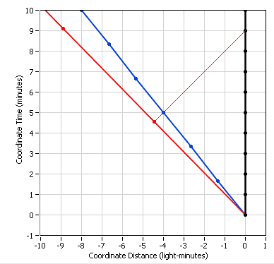

stu dent, one way to get a physical feel for what's going on is to develop an understanding of your problem in the context of a 4-dimensional universe. I'll give you a quick picture and a link for further details just in the event you might be interested in this approach. I and others here can provide more information on this if you wish. One key element of the picture below is a strange and mysterious aspect of nature resulting in different cross-section views of the universe for observers moving at different speeds. This, in large measure, accounts for the strange things going on with special relativity theory and why velocities do not add the way you might have thought. The slant of the X4 axes for the red and blue rockets relate to speeds--but we have red, blue and black frames of reference here, and the X1 axes (worlds the different observers "live in") cut across the universe at different angles as well.
You might begin by looking at the picture illustrating the different times for the red and blue observers (time dilation) as shown below. When the blue guy is at position 9 along his X4 axis (time axis) his world includes the red rocket located at red's frame position 8. But when red is at his position 9, the blue rocket is at the blue position 7. Keep in mind each is viewing 3-D cross-sections of 4-dimensional rockets.
Here is a link for more details (see post #19):
https://www.physicsforums.com/showthread.php?p=4138850#post4138850
If you were able to follow the space-time diagrams in the previous post and link, then you can easily see in the sketch below how it is that the velocities add. In the previous post we had red and blue frames moving in opposite directions at the same speed with respect to the black frame. Now we look at the speeds of the red and black frames with respect to the blue frame. The black frame moves at 1/2 the speed of light with respect to the blue frame (moving in blue's negative X1 direction). The red frame is moving at 1/2 the speed of light with respect to the black frame (moving in black's negative X1 direction).
But, now you see clearly that (1/2)c + (1/2)c does not give you 1 x c for the red frame with respect to the blue frame. Red is moving at relativistic speed in the blue negative X1 direction, but certainly not at the speed of light.

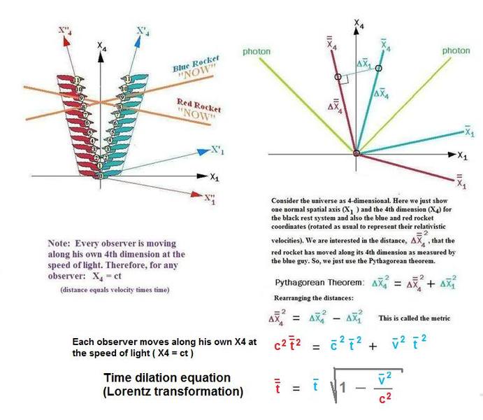

Student, don't give up on seeking the answer to that question - that question shows great insight.

In an Inertial Reference Frame (IRF) in which two spaceships are traveling in opposite directions at nearly the speed of light and one of them sends a light signal to the other one, the light signal travels at c relative to the IRF, not relative to either spaceship. That is why it has no trouble reaching the other spaceship but it will take a very long time according to the IRF. However, since the spaceships are traveling at a very high speed in the IRF, their clocks are running very slowly compared to the coordinate time of the IRF and so it will not take as long for them for the light to traverse the distance between them.
Think of speeds relative to an IRF, not relative to observers and you'll have no problem. After you set up a scenario in a given IRF, you can then transform the coordinates of the significant events defined according to that IRF into another IRF moving with respect to the first IRF and see how light also travels at c in the new IRF and produces all the same observables and measurements for each observer as the first IRF did.
This is the correct way to explain to newbies how Special Relativity describes what is happening.
I've drawn a diagram to show what happens in an IRF with two spaceships traveling in opposite directions at 0.8c. They both leave the blue spacestation at time 0 when they all set their clocks to 0. The dots mark off one-minute intervals for each spaceship and the spacestation. At 0.8c, gamma is 1.6667 so the dots for the spaceships are farther apart by that amount compared to the coordinate time. After one minute, the red spaceship sends a signal to the black spaceship at the speed of light according to the IRF. The black spaceship receives this signal when his clock reads 9 minutes even though it took over 13 minutes according to the IRF:

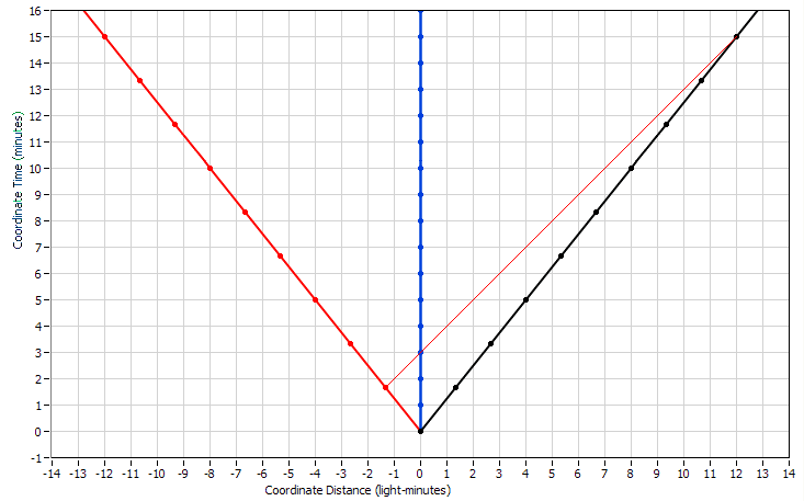

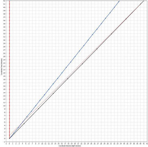

It might be useful to have the same diagram in IRF of each of the ships as well.
  • #32
Ok, here's the one for the black spaceship's IRF:
Notice that the blue spacestation is now traveling at -0.8c and the red spaceship is traveling at -0.9756c. The time dilation for the spaceship is 1.6667 and for the red spaceship is 4.5556. The light signal, emitted by the red spaceship at its one-minute mark, travels in this IRF at c to the black spaceship at its nine-minute mark, just like in the original IRF.
And here's the one for the red spaceship's IRF:
The blue spacestation is traveling at 0.8c and the black spaceship is traveling at 0.9756c. The time dilation for the spaceship is 1.6667 and for the black spaceship is 4.5556. The light signal, emitted by the red spaceship at its one-minute mark, travels in this IRF at c to the black spaceship at its nine-minute mark, just like in the other two IRF's.
We could also pick any other IRF to show all the same events and they would all be in agreement. There is nothing special about any particular IRF, even one for which any observer is at rest--what we call its own IRF. That's the whole point of Special Relativity.

  • #35

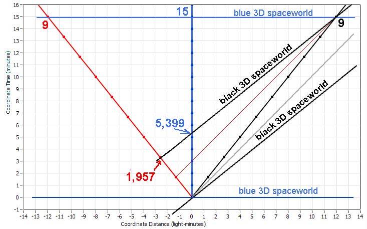

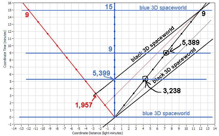

Gwelsjr,
I really appreciate your effort drawing diagrams. Good job.
Unfortunately I am not too happy with your text.
The way you explain it is as if the time dilation occurs due to the further dots pacing of clockticks on the clock worldline.
There is also a danger of interpreting your diagrams as if timedilation happens because of the taking into account of the lightbeams.
Let me put it this way:
You have drawn three different diagrams, but to see how timedilation works it is better to look at one diagram only with more information on it. I did it for you:
(For simplicity I omited what red says):
Blue notices black (and red) time dilation because when his blue clock ticks 15 (not 13 as you wrote;)), in his BLUE frame (=3D spaceworld) the black and red clock show 9.
So far so good.
Now what black says:
Black notices time dilation of blue time because "when his black clock ticks 9 seconds, IN HIS BLACK FRAME (=3D spaceworld) the blue clock is only at 5,399 sec. (9 / 1,6667).
And still IN HIS BLACK 3D world the blue 'time dilation' means: red clock is only at 1,975 sec (9 / 4,5556).
Here you see clearly that the 'slowing down' of the blue and red clock have NOTHING to with the further spacing of blue or red dots relative to the black dots (red dots are equally spaced as black, blue dots are less spaced relative to the black ones!).
On a Loedel diagram (I'm now too lazy too make one) you would see that the time dilation has nothing to do with the further spacing of clock ticks on the worldline of a clock. Time dilation is about relativity of simultaneity. (And that's only possible if you consider all events out there as observer independent entities time indications included (block universe).
Just in case you wonder what the reciprocal time dilation is for blue at 9 (see sketch below):
in blue 3D space black clock is at 5,389.
In blue 3D space when blue clock is at 5,399 the black clock is at 3,238 (= 5,399 : 1,667 ).
3D cuts through 4D block spacetime!
