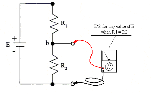

G'day FP. You've written an appropriate equation to describe the bridge (although you've changed the names of some of the given parameters: Vin for E, Vf for Vab). However, it's not fair setting the voltage supply E to zero when you're looking for R; the circuit stops behaving as intended if it has no power supply and will not meet the other operating conditions. E should be assumed to be a fixed, non-zero value (value to be determined later).
You will have noticed that the bridge is made up of two independent voltage dividers, and that both dividers split the same voltage (Vin or E). It's also been given that the numbered resistors will all have the same value. It's handy to remember that a voltage divider with two equal valued resistors always divides the potential in half.
https://www.physicsforums.com/attachment.php?attachmentid=53963&stc=1&d=1355578834
Knowing this allows you to immediately conclude that the potential at node b is 1/2 E, no matter what E eventually turns out to be.
If Vab is to be zero, then the other voltage divider containing the thermistor must produce the same voltage division since it is powered from the same voltage source, E. The same principle of equal resistors dividing the potential in half compels us to choose R3 to be equal in value to the thermistor (under the specified conditions: temp is 20 C; Vab = 0).
OK, I perfectly accept that, and even googled more info about Wheatstone to make sure I understand the formulas. But what do they mean by "excitation voltage"? What a weird question. Do they mean the voltage where Vab = 1 V, at 90 degrees, and the thermistor is therefor 208.5 ohms? (just guessing here)
Femme_physics said:
Yes, you two are right-- I changed the variables since I looked at an older example exercise and copied it.
There may be some historical reason why they chose the term "excitation voltage" to describe the voltage that powers the Wheatstone bridge, but I must confess that I'm not familiar with the story. I suppose it's as good a term as any, since E does 'excite' the operation of the circuit, in a sort of Victorian-era interpretation of the word 'excite'.
So, yes, you're looking for a suitable value for E which will produce Vab = 1 V when Rt = 208.5 Ω.
