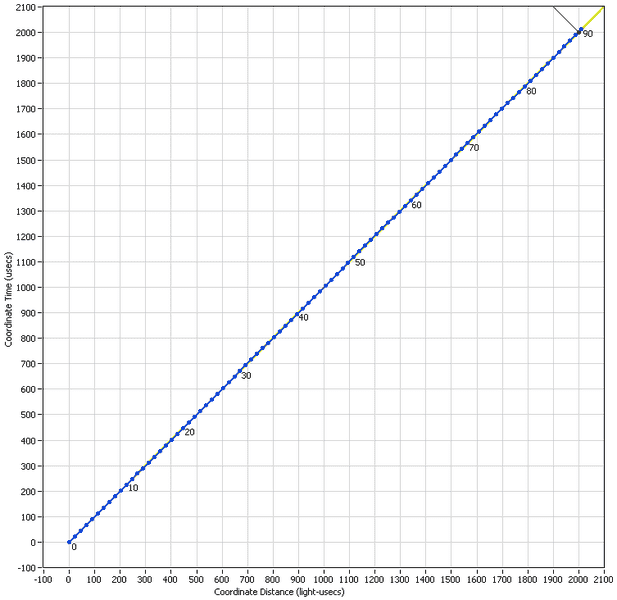

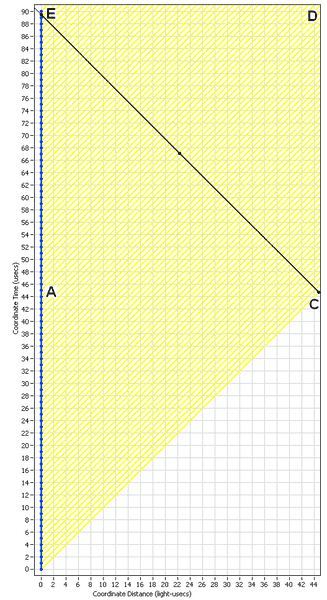

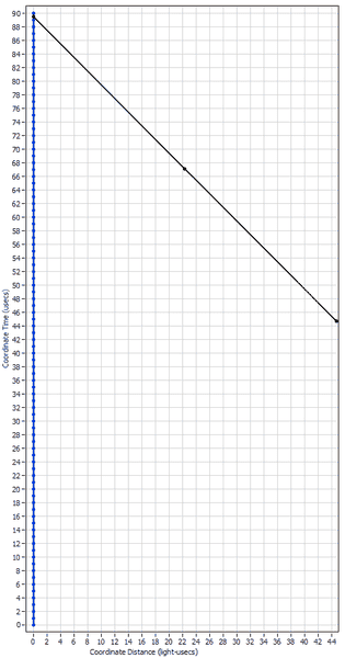

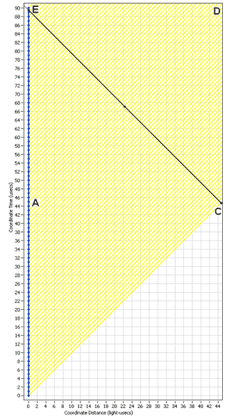

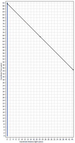

OK, it's time for some spacetime diagrams which will illustrate why the relativity of simultaneity is important. Since PeterDonis has already explained this in great detail, I'll use his labeling of specific events in my diagrams to illustrate them. I'll show them in the next two posts. Make sure you study his explanation for a clear understanding of the lettered labels. First, for the Earth's IRF and second for the muon's IRF.
First, let's look at a spacetime diagram of the Earth's IRF showing the motion of the muon. (The letters correspond to the approximate locations of the events that PeterDonis explained in his post #9--read it carefully.) I have assumed that the muon is traveling at 0.999c which makes gamma equal to 22.366 and the Relativistic Dopper factor equal to 45.71. I have considered the muon to take two microseconds to reach the Earth's surface so that it starts at an altitude of about 44.7 light-microseconds. I start the scenario at the point in time when the Earth sends a signal to the muon signifying the time on its clock (zero). It then continues to send a new signal every microsecond.
The Earth's path (worldline) in the spacetime diagram is shown as a blue line going straight up in time (because it's not moving) along the left side of the diagram at a spatial location of zero. (Since we are assuming that the muon is coming straight down in space, we can ignore the other components of space and focus only on the altitude, shown along the horizontal axis.)
The 1-microsecond signals are shown as yellow lines propagating diagonally upwards and to the right. There are a total of 90 of them sent during the scenario and they are all received by the muon during its 2-microsecond lifetime. This illustrates the Relativistic Doppler which indicates that at 0.999c, each observer will see the other ones clock running 45.71 times its own while they are approaching each other.
Now what about Time Dilation? We use the speed of each observer/clock to determine its Time Dilation (gamma) according to the IRF. Since the Earth is at zero speed, its Time Dilation is 1, meaning that the progression of its clock (its Proper Time) is in step with the Coordinate Time. This is indicated in the diagram as a series of blue dots, coincident with the progression of the Coordinate Time.
Things are different for the muon. It is represented by black in the diagram. Once it starts its trip about half way up the scenario, its path in the spacetime diagram is upwards and to the left. This indicates a decreasing altitude, ending at zero, the location of the surface of the earth, taking 2 microseconds. Because of its speed of -0.999c in the IRF, gamma for it is 22.366 meaning that each microsecond of Proper Time according to the muon's clock will take 22.366 microseconds of Coordinate Time. You can see that the muon begins its existence at just over 44 microseconds of Coordinate time and its first microsecond tick of Proper Time (the black dot in the middle of the black path) occurs at 67 microseconds of Coordinate Time for a delta of just under 23 microseconds.
Now the muon is also sending out light signals to the earth, one each microsecond, including one at the beginning of its existence and they travel at c upwards and to the left. Unfortunately, These three light signals propagate so closely to the muon itself that they cannot be distinguished from the muon in a diagram of this scale. So to overcome this problem, I have zoomed in on the detail of first diagram surrounding the events of the muon's arrival on earth:
Now we can see the three individual light signals sent out from the muon at 1-microsecond intervals and we can see that they are received on Earth at the same fast rate as what the muon receives the signals from earth. (You really have to copy the image and print it out so you can draw in extra signals to see that 23 of them would fit between the 89-microsecond tick of Earth and the 90-microsecond tick.)
So the bottom line for the Earth's IRF is that time is dilated for the muon so it can survive the 45 microseconds it takes to get to the earth, even though its half-life is less than 2 microseconds.

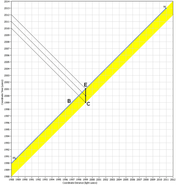

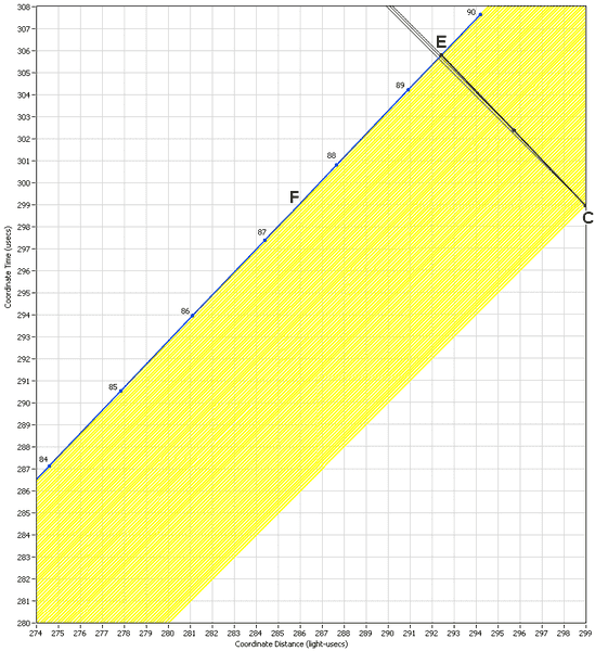

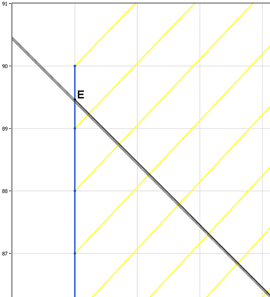

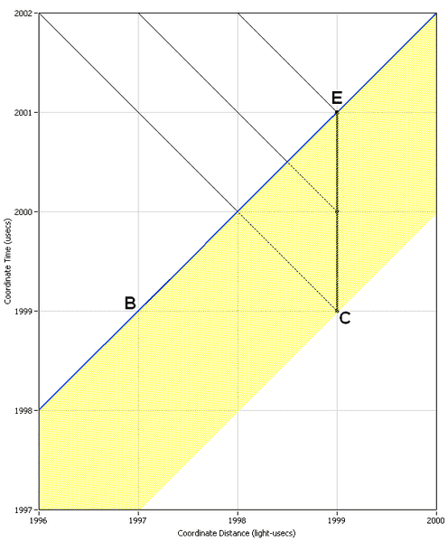

Now we want to look at the muon's IRF. If we simply transform all the events, using the Lorentz Transformation, in the first IRF by a speed of -0.999c, we get the following spacetime diagram:
This clearly shows us that the Earth is moving at an ever increasing distance to the muon which is stationary at about 2000 light-microseconds, taking about 2000 microseconds of Coordinate Time at 0.999c to get there. Notice how the Proper Time of Earth's clock is Time Dilated by the factor of 22.366 as evidenced, for example by the Coordinate Time of 2000 divided by the final Proper Time of 88.5 yielding 22.6, close enough for eye-balled calculations.
But to see the interesting detail, we need to zoom in on the final moments of the Earth's path:
I have made this diagram to show the last two ticks of the Earth's clock to get a perspective of how the timing works. Here we can see that the muon, indicated by the vertical black line is stationary at a location of 1999 light-microseconds and lasting for 2 microseconds of Coordinate Time. Now we can see the three individual light signals (shown in black) sent out by the muon at 1 microsecond intervals. We can easily see that they are received at a rate of 1/45th the rate of the Proper Time ticks of the blue earth. We can also see the flood of yellow light signals sent out by the earth, but long ago and far away in this IRF.
We zoom in some more to see the details even more clearly:
Now we can see the individual yellow light signals coming up from the Earth (up from below and to the left of the diagram) and there are the correct number of them. Copy and print out the image if you want to count them out precisely.
Here is where we can easily see the Length Contraction of the distance to the earth, as explained by PeterDonis. In the muon's IRF, the distance the Earth is away from the muon at its creation, event C, is indicated by the event B, giving a distance of about 2 light-microseconds.
So that pretty much covers everything. Any questions?

ghwellsjr, great diagrams! Just one comment to add: in your first diagram, showing events A, C, D, and E in the Earth frame, note that event B would be on the Earth's worldline just a bit below event E. This gives another point of correspondence between that diagram and the diagrams drawn in the muon's frame.

It's not 0.
If you look at either of the last two diagrams, you will see that the muon's creation in the upper atmosphere occurs at event E. The coordinates of that event in this particular IRF that I have defined in which the muon is at rest are (approximately) t=1999 usec and x=1999 light-usecs. At that time, the Earth's surface is at (approximately) x=1997 light-usecs. This gives a distance of approximately 2 light-usecs. Note that I said in my earlier posts that these numbers are approximate because we are "eye-balling" them from the diagram.
In post #9, section (4), PeterDonis defined an event which he called event B, just for the purpose of determining how far away the Earth was at the time of the muon's creation, in the muon's IRF. Nothing is actually happening at this event, that is, even though the event is on the earth, it has no significance or any awareness for anyone on the earth.
This might seem artificial but it is no different than what he did in the Earth's frame when he defined event D in section (3). There again, nothing is happening at that event which has any significance or awareness to anyone in the scenario. Yet, somehow the distance we determine between the Earth's surface and the creation of the muon in the Earth's IRF seems obvious and natural but doing the same exact thing in the muon's IRF seems artificial and arbitrary.
I would encourage you to go back and study PeterDonis's post #9 until this all makes perfect sense to you. It really helps (me, at least), to be able to look at some diagrams for a particular example while studying Peter's explanation. You should keep in mind, as I pointed out earlier, that the particular set of coordinates that I came up with for the Earth's IRF and the transformed muon's IRF are just my arbitrary decision. I'm sure Peter (or anyone else) would have come up with a totally different set of coordinates (even for the same example) if he had chosen to do so.
But this raises a very important aspect that Peter failed to point out which I would like him to address and that is, how do we determine the exact coordinates for event B? When you draw a diagram for a specific example as I did, we can just follow the horizontal grid line from event E to where it crosses the path of the moving Earth and that shows us where event B goes. But it's only approximate because we're eye-balling off a diagram.
This is not an issue for determining the exact coordinates for event D in the Earth's IRF because, I defined those coordinates when I set up the example. I said the muon was created 2 microseconds (in its IRF) before it reached Earth and it traveled at 0.999c straight down. I used the calculation of gamma to determine how long in the Earth's IRF it would last and then I used its speed (which is the same as the Earth's speed in the muon's IRF) to determine its altitude when it was created (event A). You can carry out this calculation with as much precision as you want. So whatever arbitrary coordinates you want to use for event E, since we know the spatial distance between events A and C, the same spatial distance applies between events E and D, and those two events have the same time coordinate so we're done.
However, we cannot do something so easily for determining the coordinates of event B. We have to rely on transformed coordinates, at least, that's how I know to do it. The time coordinate is no problem, it's the same as the time coordinate that was part of the description of the scenario (2 usecs prior to Earth impact). But since nothing happened at event B in the Earth's IRF, how do we determine its coordinates so that we can transform it to the muon's IRF?
I'd like to hear Peter's explanation.
Of course, we can always cheat. Since we know the Earth's speed in the muon's IRF and we know how much time transpires from its creation to Earth impact (2 usecs), we can trivially calculate how far the Earth had to travel (d = vt = 0.999c * 2 usecs = 1.998 light-usecs) and this answer must agree exactly with doing it the "hard" way. But cheating doesn't illustrate the length contraction of the Earth and the distance to the Earth in the muon's IRF which is what we are interested in so I'd very much like to hear how Peter will describe the process. Maybe he will have a better way than the way I have come up with.

Look at the spacetime diagrams in post #12 in which the Earth is at rest. It is shown as a vertical blue line. The light signals that are sent from the Earth to the muon are shown as yellow lines going up and to the right at a 45 degree angle.
Now look at the spacetime diagrams in post #13 in which the muon is at rest. It is shown as a thick vertical black line. The light signals that are sent from the muon to the Earth are shown as thin black lines going up and to the left at a 45 degree angle.
Any object that is at rest in an IRF will be shown as a vertical line. All light signals will be shown as lines at a 45 degree angle. How do you propose to show light at rest in its own frame in which it must be drawn as a vertical line at a 45 degree angle?

As Doc Al pointed out, you have to use the correct forumula to add (or subtract) speeds. I have already shown you spacetime diagrams in which the Earth is at rest and in which the muon is at rest. Now I want to show you another spacetime diagram for an IRF in which both the Earth and the muon are traveling at the same speed. This would be kind of like the rest frame for car (A) except that there is nothing at rest in this IRF and instead of traveling away from each other as the cars are, the Earth and muon are traveling toward each other.
The common speed of the Earth and the muon in this IRF is not just one-half of their relative speed of 0.999c. Instead it is 0.95625c. You can plug this into both inputs of the Velocity Addition formula (see wikipedia) and verify that they add to 0.999c. The value of gamma at 0.95625c is 3.41821. Here is the diagram:
Note first off that both the Earth and the muon are time dilated by the same amount. You can see that 2 microseconds for the muon, from event C to event E is the same coordinate interval as 2 microseconds for the earth, say from its Proper Time of 84 to 86.
Note secondly that the distance between the Earth and the muon at the time of the muon's creation in this IRF is about 13 light-microseconds as depicted by the distance from event F to event C. Since both the Earth and the muon are traveling at 0.95625c, they each cover half that distance and meet at event E. It takes them each 6.83642 microseconds of coordinate time to travel that coordinate distance but since they are both time dilated by the same amount, it is only 2 microseconds of their own Proper Time.
Also note that the light signals that each one sends and receives is exactly the same in this IRF as it is in the two previous IRF's. That's an important lesson to learn. There is no difference in terms of what observers measure or see when described by different IRF's that are transformed from one to the other. You can still count the same number if yellow signals received by the muon during its trip in this IRF as are in the previous two IRF's. The muon sends out two black signals to Earth which receives them about half way between its Proper Time of 89 and 90 microseconds. None of these features could possibly work with your idea that light could have it own rest frame.
One more thing: you said that the equations show that time and space are linked, as one expands the other contracts but if you look at the three sets of diagrams, you will see that as we transform to different IRF's the coordinates for events tend to all exand or contract together. I think you need to study these diagrams and realize that they are all simply derived from the coordinates of events in one IRF transformed into different coordinates for other IRF's.
