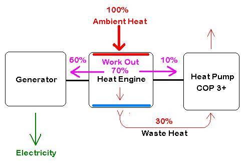

Well, I was allowed to borrow an illustration from one of the members in another forum I am in.
Here is the illustration.:
For the record, we are NOT discussing over unity. Just very curious hobbyists.
BTW, your equation for heat engine equation seems to allow 100% efficiency. I believed the absolute maximum theoretical efficiency was about 70%...
Vidar
In that image the heat pump and the heat engine share both the same hot reservoir and the same cold reservoir. Everything in my posts 5 and 8 applies, specifically the maximum possible COP is 1/0.7=1.43 so you would have to use all of the work from the ideal heat engine to power the ideal heat pump.

With independent I ment that the hot side of the pump and engine is both in free air. Their physical surfaces/heat sinks do not neccessarily have the same temperature even if the air around them have constant temperature. Only the cold sides have the same temperature.
Regarding the equation: If TCE is 0 K you have 1 and remove zero - 100% efficiency. If TCE is 20K and THE is 273K, the efficiency is 93%.
Vidar
The heat pump will have at least the same temperature difference then, and therefore it cannot be "better" than the heat engine - for ideal engines and the same air temperature, they just cancel.
That is correct, a cold reservoir at absolute zero would allow 100% efficiency - as upper limit on the efficiency of real machines. An upper limit of 100% is trivial, but not problematic.
Yes, so free air is the hot reservoir for both. All of my comments in 5 and 8 apply. You have to use all of the work from the ideal heat engine to run the ideal heat pump.
I thought that COP was describing the relationship between input work and output heat of a heat pump. Say you have a heat pump with COP of 10, is it so that this heat pump suddenly drop its COP to 1.43 as soon as it is connected to a heat engine with 70% efficiency? And, does it increase COP to 20 as soon as it is connected to a heat engine with 5% efficiency?
Vidar
Yes. Using my notation above [itex]COP_{heating}=Q_{HP}/W_P[/itex] for a heat pump in heating mode.
There isn't really any such thing as a heat pump with a COP of 10. There is a heat pump with a COP of 10 operating between two specified temperatures. The COP is strongly dependent on the two temperatures. If you have a perfect heat pump, the most efficient possible, then its COP depends only on the output temperatures as follows:
[tex]COP_{heating}=\frac{T_{HP}}{T_{HP}-T_{CP}}[/tex]
It isn't that hooking a heat pump up to a heat engine reduces its efficiency, it is that a heat engine is most efficient for large heat differentials and a heat pump is most efficient for small heat differentials. So hooking a heat pump up to a good reservoir for an efficient engine will make a very inefficient heat pump.

The point is that a heat pump and an engine working together, regardless of if that is considered possible or not, does not necessitate that both work between the same two "reservoirs".
I agree. That is simply how Low-Q drew the arrangement. I even proposed and analyzed an alternate arrangement where they only shared one reservoir. But Low-Q's arrangement clearly has both the heat pump and the heat engine connected to the same two heat reservoirs. I would be glad to discuss and analyze alternate arrangements.
However, in order to be a heat engine and in order to be a heat pump each must be connected to two reservoirs. They need not be the same reservoirs, but each needs two, by definition.

The diagram is just a kind of energy flow chart. I just dashed it off. I'm not sure that Low-Q in his enthusiasm actually understood it fully. I never really explained it in the other forum where it was posted.
The actual working principle was outlined in an article by Tesla. I'm not so sure myself that the concept could actually work but so far I've seen no mention here of the working principle it is supposed to represent.

I can still take the condenser coil and the expansion coil and twist one or the other or both around one or both ends of the heat engine and the heat engine will still run. All within the same "reservoir" as we have already agreed.
At any rate, Tesla's idea as represented in the diagram could not really be understood, I don't think, if it cannot be grasped that the only REAL permanent "reservoir" of heat represented in that diagram is Ambient Heat. Both the heat pump and the engine are operating within that one environment.
There is a "Heat Sink" of sorts which might be considered a "reservoir". About as much so as the evaporator coil of a heat pump sitting on a table. But we have dispensed with that notion.
The heat pump in the diagram is maintaining an artificial heat sink within the ambient environment. That is not really a "reservoir". Not in the sense that term is generally used. Naturally, this artificial sink would have to be protected. Insulated. Like an ice box. The only heat entering the ice box would be the waste heat from the engine.
I'm not at all sure that Low-Q fully understood all that. Maybe it isn't essential to his argument. I don't know. I thought some clarification might be in order anyway.
To understand what Tesla was driving at, it is also important to understand that heat is not really a fluid that flows from hot to cold like water. That was central to his argument. But that is essentially what is meant when using the term "reservoirs". Heat is energy which can be transmuted into other forms of energy.
It is the role of a heat engine to transmute heat into some other useful form of energy.
Not all the heat running the engine flows from the heat source into the heat sink. If the heat engine is efficient then it won't be dumping much waste heat into the "ice box".
