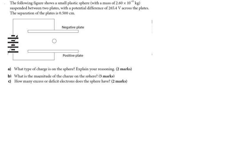

see attachment for pic of diagram and question
b) what is the magnitude of the charge
c) what is the number of excess or deficit electrons?
m=(2.6*10^-15)kg
Δv=265.4V
r=0.005m
q=Ne
where (q=charge), (e=electron), (N=# of excess/deficit electrons)
ε=ΔV/r
FE = qε
FE = Fg
qε=mg
q(ΔV/r)=mg
q=mgr/ΔV
q=(2.6*10^-15)(9.8)(0.005)/265.4
q=4.8*10^-19

oh, and assuming B) is correct, here's the answer to C):
q=Ne
N=q/e
N=(4.8*10^-19)/(1.6*10^-19)
N=3
3 deficit electrons, since charge = (+)

ε=kq/r^2
That is related to the electric field from the charged object itself, not the electric field from your setup. If you would work with units, you would see that it does not have the correct units.

There is no alternative way to check your answer, just the formula you used to calculate the value.
Well, the nice result of "exactly" 3 electrons is an indirect way to check the result - a value of 2.5 would be weird.

V/m is the electric field strength.
If you mean N/C: Ok, then the units do not show the problem, as N/C = NV/J = V/m
