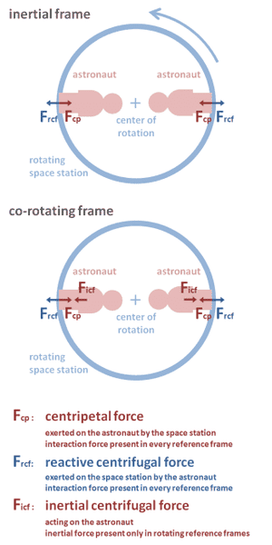

It is really not that confusing if you make clear which reference frame you consider.
There is only one force on each astronaut provided by the space station. That is the centripetal force provided by the tensions in space station structure. Each astronaut provides a force on the space station that creates tensions within the space station structure and result in a centripetal force on the other astronaut.
So one could say that the reaction force to the centripetal force on one astronaut is that astronaut's (centripetal) force on the other astronaut arising from the structural tensions within the space station structure. In that sense, all the forces are centripetal.

Andrew Mason said:
Each astronaut provides a force on the space station...
Which points outwards, away from the center of rotation. That's why it is called "centrifugal".
Irrelevant. There is a direct local interaction between astronaut and station with two equal/opposite forces: one is centripetal, one centrifugal.
It depends on how you look at it. The force applied by astronaut1 causes astronaut2, who is mechanically connected to the space station, to accelerate toward the centre of the station. If astronaut1 stopped applying this force, astronaut2's acceleration (and the acceleration of the rest of the space station) toward the centre of the space station would decrease. So if you want to associate the direction of a force with the acceleration that it causes, the direction of the astronaut's force is centripetal.

A.T. said:
I don't see how you can confuse the two. One is an interaction force that exists in every frame, the other is an inertial force that exist only in rotating frames. The diferences are listed in the table here:
http://en.wikipedia.org/wiki/Reactive_centrifugal_force#Relation_to_inertial_centrifugal_force
Calling it "centripetal" as you suggest, despite the fact that it points away from the center, that would be confusing.

Andrew Mason said:
It depends on where the force acts.
Look at the picture again. Try to figure out where the blue arrows start. That's where the astronaut applies the force to the space station.
Andrew Mason said:
If one says that a force acts on the centre of mass of the body...
...then one obviously has a serious case of cognitive dissonance.

A.T. said:
What acceleration? Consider a non-rotating planet with you on it. Newtonian gravity. There is no acceleration. It is all static. But there is one interaction (electro-magnetic) between your feet and the ground, with a 3rd law force pair. And there is a second interaction (gravitational) between you and the planet, with a second 3rd law force pair. Two times action & reaction without any change in motion.
I agree. Those are the forces and the interactions. They all sum to 0. But you don't need the third law to analyse that. There is no "action" (ignoring the acceleration relative to the sun and other planets etc.) . Newton made the distinction between force and action. I didn't.
Nope, the third law pairs are individual forces, not accelerations.
