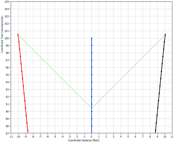

Ahh--the slow transport of clocks--the myth that it is better than Einstein's synchronization convention. In fact, it is no different. Let me show you why.
First off, let me say that when you want to adopt a state of absolute aether, it is no different than selecting an Inertial Reference Frame (IRF) so you don't have to feel apologetic. But the good news is that you can use all of Einstein's Special Relativity to analyze what would happen in a state of absolute aether.
You have stated many equivalent things in this thread, including that you can synchronize two remote clocks with a signal that originates at a location equidistant from both clocks or that you can use this technique to confirm that two such clocks are in sync, including two clocks (or watches) that were slowly transported either from the end points of a rotating rod or from the midpoint of the rod to its extremities.
These are all different expressions of the same theme, slow transport of clocks. So in order to not have to analyze each one of them separately, I'm going to analyze just one scenario where we have three co-located clocks and then we slowly move two of them in opposite directions by the same distance and then we will use a signal sent from the stationary clock to confirm that they continue to remain in sync.
I'm going to use a distance measure of feet and I'm going to define the speed of light to be one foot per nanosecond. We're going to move the two clocks at a speed of 0.1c for 100 nanoseconds according to their own Proper Time which will move them about 10.05 feet. Just before they get there, we're going to send signals from the stationary clock and show that they arrive at the same time according to the times on the two slowly moved clocks. Here's a spacetime diagram to illustrate this in an IRF in which the clocks started out at rest:
The dots on each worldline represent Proper Time one-nanosecond ticks of each clock. They all started out at the origin of the frame set to zero so we see them 100 nanoseconds later where the last dot appears for each of them. We have to send the signal shown in green coming from the stationary clock at about 90.5 nanoseconds in order for them to arrive exactly when the two slowly moved clocks come to rest with readings of 100 nanoseconds on them.

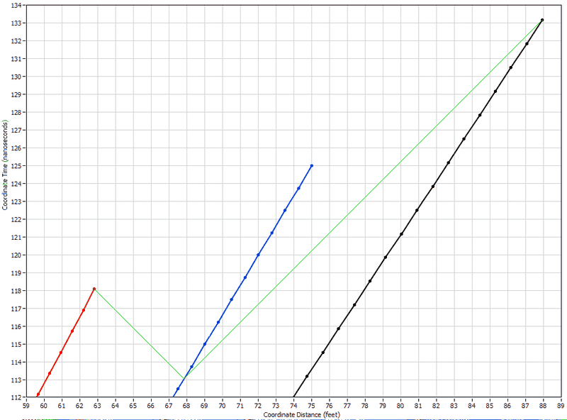

Now we look at the same thing in an IRF moving at -0.6c with respect to the first one:
Here we see that even though the two slowly moved clocks receive the signals sent from the stationary clock at the same Proper Times for both of them, they are not in sync.
The point of this exercise is to illustrate that it is impossible to determine by light signals or by slowly moving clocks any sense of absolute synchronization. They will both agree but still not indicate any synchronization with respect to a state of absolute aether.
Ok, ghwellsjr, thank you!
I have been convinced! And by joining the two end-points of the red and black lines in the second diagram, we drop back to the rest frame of the moving rod from which we emitted the slow clocks!
