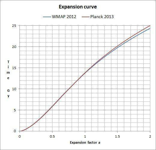

A comparison of the present Planck with the present WMAP maximum likelihood data as expansion curves, as per TabCosmo7 tables.
Expansion curve differences only really noticeable in future, although the inflection point for zero acceleration (deceleration-acceleration crossover) shifts from 7.4 Gy to 7.7 Gy, as calculated from second Friedmann equation.
