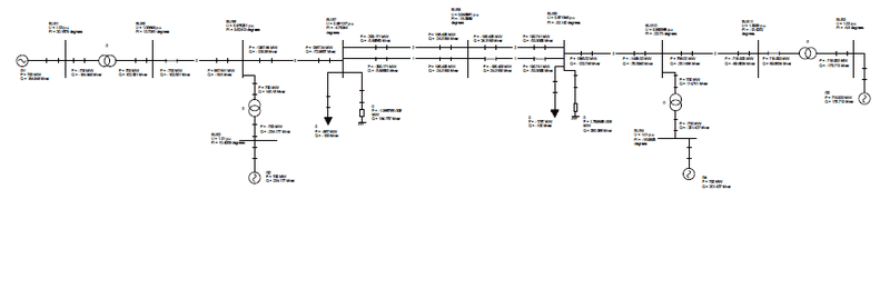

I have done a project on such an topic and may share some of the results we found. The network is taken from the book "P. Kundur - Power system stability and control". The analysis is done in SimPow (http://simpow.com/)
Here is a overview of the system:
The network comprises of two areas (left and right), with two generators each (AC source symbol), loads (black triangle) and capacitor banks. The two areas are connected with two parallel tie-lines securing the power flow from one area to the other.

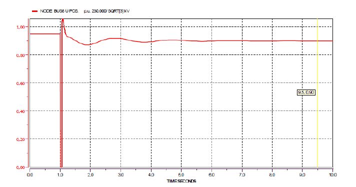

At t=1 sec a three phase fault appears on the bus in the middle (50ms duration). Here is a plot of the voltage on the actual bus:
As noted the voltage oscillates and settles to a lower value after a few seconds.

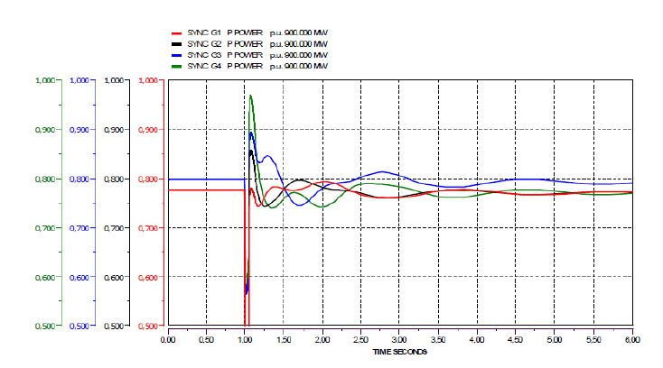

In the next plot you see the active power generation of each generator during and after the fault:
Notice the large oscillations. But the system remains intact and stabilizes to a new steady state.
The last plot may give you insight into your solution regarding current measurement. After a disturbance the current fluctuate, but would you like the governor to react to any of these transients? What about the time delay in the system?

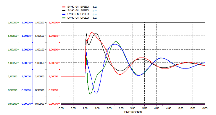

In the same case (short-circuit) the speed of the 4 generators are shown below:
As noted the generators in each area 180 degrees phase shift in rotor speed. Hence they swing "against" each other and power is sent back and fourth between the areas causing instability.

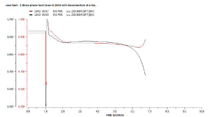

The next plot is regarding voltage stability, here a short circuit has occurred and one of the two tie-lines is disconnected.
Here the voltage collapses after 5 sec. In other real world scenarios there has taken considerably longer time for the voltage to collapse, giving the impression that the system was stable after the fault but in reality it was not.
For sure this topic is very interesting, but the problem one is faced with are very complex systems, with many factors working together. A network consists of several hundreds-thousands generators and loads all connected and contributing to the stability. Where I live generators in the north of the country swings against generators in the south during a disturbance, that is 2000 km of overhead power lines in between them.
Regarding PLC, this is more of a engineering profession when projecting and installing power plants and such. Not in the sense of power system analysis. If you ever are going to visit a power plant, the basic knowledge of PLC operation will come in handy, but every manufacturer has its own software so specializing in one type might be to early. PLC these days are more like computers, with all its flexibility, than those old ones with only timers, AND, OR gates etc.

I can't quite make out the printing on your one line diagram so can't tell which generator is which.
As one would expect the generators all accelerate during the fault , if I read the charts right?
Are the two that accelerated most (red and black) nearest the fault, or way out at the ends?
just curious, not challenging the simulation.

Generators are in the following order from left to right: G1, G2, G4, G3. See the attached PDF for an overview in larger format.
As for the distance to the fault I think all generators on each side has equal distance. That is G1 and G3 have equal distance to the center bus (fault bus). G2 and G4 the same distance. I can't say for sure as I don't have the data in front of me right now.
As for the initial state one can see in the attachment that power flows from left to right due to the larger load in the region on the right. All generators has equal initial production.
The generators models are 4. or 5. order, that is, 4 or 5 differential equations for each generator. So yes inertia is an important parameter. Other parameters are the transients reactances in d and q axis. , time constants etc.

The generators on the side with excess generation sped up more than those on the side short of generation.
That makes sense.
Perhaps the most interesting feature of your one line drawing is it shows angles. One sees the phase shift along every line.
Those power lines look absolutely static when we see them crossing country on their towers.
But really they are analogous to mechanical drive shafts - power transmitted is equal to phase difference between ends divided by stiffness, in this case 'electrical stiffness' (admittance, 1/Z).
So in reality the power system is a dynamic thing, with inertias connected by flexible links and plenty of energy input.
That's a spring-mass system subject to Newton's laws and harmonic motion. Just like we studied in freshman physics and sophomore dynamics.
It might as well be living and breathing. It just looks static.
That is shown in your speed charts where red and black's speed criss-crossed blue and green's speed. The system was in a torsional oscillation like a rotary pendulum. In your mind's eye grab both ends of that one line diagram and give it a twist. When you let go it'll rebound in a (hopefully) damped torsional oscillation.

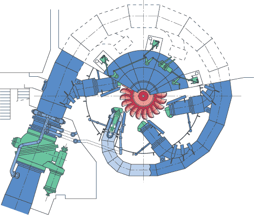

I have got a problem. I want to expand my turbine model into multiple-jet turbine model.
The only difference between single-jet and multiple-jet is in the Q(m^3/s - water flow)
So far I calculated Q on this way:
Q=k1*k2*Q_max
Q_max-max water flow
k1-needle openness factor (from 0% till 100%)
k2-deflector openness factor(from 0% till 100%)
In islanded mode servo motor regulated k2 and k1 was const. and in GRID mode k1 should be controlled and k2 set to 100%
My problem is how to expand this into multiple-jet, let's say the number of jet's is "n".
I also don't understand how many needles and deflectors turbine has with multiple jets.
For example let's say turbine has 4 jets, but how many needles? 1 or 4 too, and how many deflectors?

A needle is located inside each jet/nozzle, also there is a deflector on each jet. So the number of needles and deflectors is equal to number of jets.
As for the water flow, I would treat all the jets as one single unit, hence multiply your formula with n (no. of jets), if Q_max is max flow per jet.
Each jet is usually not controlled individually (if ever?), so k1 and k2 would be variables controlling the total water flow.
  • #33
Ok, that sounds good :P
Following that Water flow is Q=n*k1*k2*Q_max_per_single_jet
In this case I don't need to care about how many nozzles/jets should currently work(1,2, or even total number n) to compensate current load demands, all I have to care about is value of k1 or k2, depending in which mode I am.
Ok, I have got one more thing to ask. When I am controlling the needle(GRID mode) should I use same servo-motor output which I use in islanded mode during the deflector control.
Same servo-motor moves the needle and deflector too? I guess in reality that's not the case, but I don't see the problem in a case of simulation.
  • #34
The two valves (needle and deflector) got different actuators (motors), and different control scheme. The problem you face is related to time constants. The control circuit for the needle has a "fictive" time constant for how fast the needle can operate. That is, if a step response is applied (decreased power output) the needle moves much slower than physically possible. This time constant is independent of grid or island mode.
The deflector has a different time constant.
When I come to think about it, (I basically only have a text-book knowledge about the system), I would guess the deflector operates in states; on or off. Not anything in between. The reason for my statement is that once you interfere with the water-stream you will shift the direction of the stream and the impact point on the turbine-wheel. This in connection with the precision of the deflector would give a system with poor control of power output. So k2 would either be 1 or 0, this again would reduce the system degrees of freedom (control variables). You may research the topic further.
