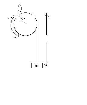

system 1:
a rope rounded to a cylinder, the rope ends with a mass m and creating a pendulum with a maximum angle creating on a vibration [tex]\theta[/tex], the length of the rope while [tex]\theta = 0[/tex] is [tex]\ell[/tex], the wight of the rope is neglected
find the equation of motion using lagranges equation..
Here is the CORRET answer:
[tex](\ell + r\theta)\ddot{\theta} + r\dot{\theta} + g sin\theta = 0[/tex]
here are the steps i took, i didn't get the same result, i want some body to give me step by step,

Does the length of the rope not change as the pendulum swings? Perhaps I'm just not understanding the situation.
edit: could you maybe include a diagram?
No, the length doesn't change, but the hight is changing due to the angle
The cylinder is stationary, the mass swinging is the pendulum. The potential is not just [tex] mgr [/tex] but [tex] mgr \cos(\theta) [/tex]. As the mass swings from side to side, teh rope will change length giving the other term for the kinetic energy.

The first step is to define your coordinate system. What does [itex] \theta [/itex] mean? Where is 0?
0 is in the center of the cylinder
Have you tried including the rotational kinetic energy of the cylinder into T?
Pete
I though [itex] \theta [/itex] was an angle?
Your drawing seems to indicate that the cylinder is rotating? I think the problem is for a pendulum which swings off of the cylinder. Please explain your coordinate system. What is [itex] \theta [/itex] ?

MY GOD, the cylinder is rotating i meant with 0 the center of the coordinates, [tex]\theta[/tex] is the angle creating by the cylinder rotation in the 2 sides
This is not clear to me, where is [itex] \theta = 0 [/itex] and how does it realate to the rope?
I do not think that you have a handle on the potential energy, mainly because you are misinterpreting the problem. Consider a pendulum which swings from the cylinder, [itex] \theta [/itex] is the angle from the horizontal to the point of tangency of the rope. This is consistent with the initial point given in your problem definition of [itex] \theta = 0 [/itex] means the length of the rope = L . To find your potential energy you need to find the distance the mass is lifted by moving the point of tangency through [itex] \theta [/itex] radians. This is a geometry problem.

http://home.comcast.net/~rossgr1/Math/potential.pdf and how I see the potential energy term. I have not used it to compute the equation of motion, but perhaps this will get us on the same page as far as the coordinate system goes.
Thanks integral, i'll give a try with this hight, and i'll return to tell you the result,
Thanks integral, you calculations are right, i got the answer,
EXECELLENT! :smile:
I hope that picture is of some help in undersanding where the expression for h came from. It is common in this type of problem that you must understand your coordinate system and carefully derive each expression by drawing a good diagram and aplying geometry and trigonometry.
