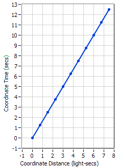

The best way I know to understand Time Dilation is to look at the geometry of the spacetime diagrams for a couple of Inertial Reference Frames (IRFs) depicting the same situation and using the Lorentz Transformation process to get from one IRF to the other. The situation we will consider is a clock that is stationary in the first IRF. The spacetime diagram is simply a plot of the position (or distance from the spatial origin) of the clock along the horizontal axis versus time along the vertical axis. Here is the first diagram:
Pretty boring, isn't it? It shows that as time progresses from 0 seconds to 10 seconds, the clock stays at the spatial origin with the coordinate at 0. I also show each second of time as a blue dot.
Now we use the Lorentz Transformation to see how an IRF moving to the left at 60% of the speed of light would depict this same situation:
In this IRF, the clock is moving to the right at 0.6c. You can see that because at the Coordinate Time of 10 seconds, the blue line is at the Coordinate Distance of 6 light-seconds. You can also see that what took 10 seconds in the first IRF takes 12.5 seconds in this IRF.
Things take longer when they are moving in an IRF. And this is the simplest explanation of Time Dilation that I know of based on Special Relativity. Does it seem simple to you? If not, please let me know where you need some more explanation.

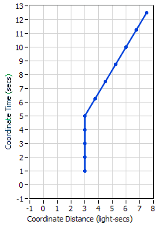

It's not that Time Dilation is not real-it's that it is frame dependent which means that we cannot establish an absolute reality to it. Clocks can change their actual rates when they accelerate, it's just that we cannot say that a clock is Time Dilated after it accelerates and not before or vice versa unless we specify an IRF.

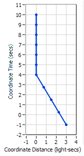

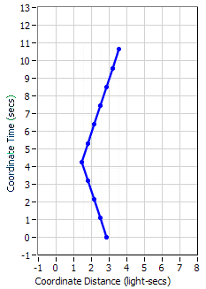

Let me illustrate with a couple spacetime diagrams based on a modification to the ones in post #10. Let's say in the first diagram that the clock started out traveling to the left at 0.6c and that at a time of 4 seconds, the clock changes to being at rest:
Now we will transform this scenario just like we did before and we get:
Now looking at these two diagrams which represent exactly the same scenario, we see that the clock is Time Dilated to begin with in the first diagram and ends up being Time Dilated in the second diagram.
We can even find an IRF in which there is no change in the clock's Time Dilation as a result of the same acceleration:
This IRF is moving at -0.333c with respect to the first one which results in the clock changing direction but maintaining the same speed before and after the acceleration.
There are even IRF's where the clock is Time Dilated before and after the acceleration to different degrees. We can never say what the Time Dilation of a clock is without specifying the IRF.
