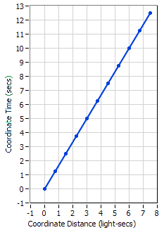

The best way I know to understand Time Dilation is to look at the geometry of the spacetime diagrams for a couple of Inertial Reference Frames (IRFs) depicting the same situation and using the Lorentz Transformation process to get from one IRF to the other. The situation we will consider is a clock that is stationary in the first IRF. The spacetime diagram is simply a plot of the position (or distance from the spatial origin) of the clock along the horizontal axis versus time along the vertical axis. Here is the first diagram:
Pretty boring, isn't it? It shows that as time progresses from 0 seconds to 10 seconds, the clock stays at the spatial origin with the coordinate at 0. I also show each second of time as a blue dot.
Now we use the Lorentz Transformation to see how an IRF moving to the left at 60% of the speed of light would depict this same situation:
In this IRF, the clock is moving to the right at 0.6c. You can see that because at the Coordinate Time of 10 seconds, the blue line is at the Coordinate Distance of 6 light-seconds. You can also see that what took 10 seconds in the first IRF takes 12.5 seconds in this IRF.
Things take longer when they are moving in an IRF. And this is the simplest explanation of Time Dilation that I know of based on Special Relativity. Does it seem simple to you? If not, please let me know where you need some more explanation.

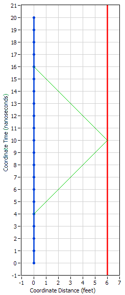

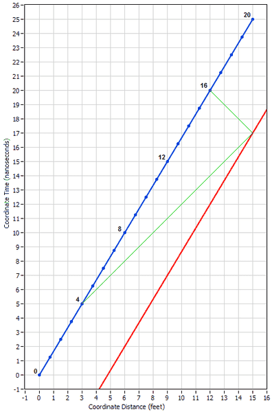

Perhaps a couple spacetime diagrams will help to illustrate his explanation of Length Contraction. First, the IRF for the rest frame of the train:
The observer is shown in blue and her mirror is shown a measured six feet away in red. I'm showing just one cycle of a light pulse traveling from her to the mirror and back.
Now, the IRF for the ground rest frame:
Can you see that while the light is moving away from the observer on the train, it is going at c-v relative to the observer and after it reflects off the mirror it is going c+v?

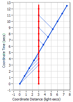

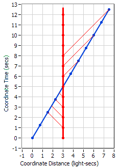

The formula for Relativistic Doppler is:
√((1+β)/(1-β))
where β is the approaching speed as the ratio v/c.
For a departing speed it is simply the inverse of the above.
So in the second IRF shown for Time Dilation, β = 0.6 so:
√((1+β)/(1-β)) = √((1+0.6)/(1-0.6)) = √(1.6/0.4) = √4 = 2
This means that while approaching at 0.6c, each observer will see the other ones clock ticking twice as fast as their own and while departing at that speed, they will each see the other ones clock ticking at half the rate of their own.
Unlike Time Dilation for which each clock/observer/object is independent of all the others and has a Time Dilation dependent only on their individual speeds in the IRF, Relativistic Doppler is an effect between two inertial clocks/observers/objects. So I have added a stationary red observer in the second IRF from above. First I show the light signals sent each nanosecond from the traveling blue observer:
Note how in the bottom of the diagram, while the blue observer is approaching the red observer, the red observer sees two ticks of blue's clock for every one of his own. Then after they cross paths while they are departing, red sees blue's clock ticking at one-half the rate of his own.
Now what does blue see of red's clock?
Same thing--even though we are only using one IRF in which red is at rest.
And please note that the Time Dilation factor of 1.25 is not observable by either observer, only the Relativsitc Doppler factors are.
