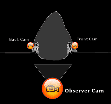

Now, my question is:
– What happens if we place two cameras at front & end of the train, directed towards the observer, recording the trip through the tunnel together with the time-code from two synchronized atomic clocks (at front & end), and also having the observer recording the trip through the tunnel. What will we see when we play the 3 videos? It can’t possibly show the observer filming a completely disappeared train, while the observer is also simultaneously being filmed from the front & end of the same disappeared train?? :bugeye:
My guess is that the following will happen:
  • The camera in the front of the train will record the observer, and then it gets black and then shortly after, the observer reappears when the front is out of the tunnel.
  • The camera in the back of the train will record the observer during all the time above, and then it gets black and then shortly after, the observer reappears when the back is out of the tunnel.
  • The observer will for a moment record the train disappearing completely in the tunnel.
  • Now, the only way to reconcile this paradox is disagreements on timing/events, and this time the disagreement must also occur onboard the train within the same frame of reference...?
Is this correct? Or am I missing something??

Sorry Doc, my fault. In the video Mike is talking about “the trainspotter”. This is my “observer”, i.e. a stationary person filming the event from a distance. Here’s a picture with the 3 cameras (front/back is filming “the observer”):
Note: This is not what the trainspotter/observer will see according to the video.
EDIT: bahamagreen got it right, thanks!

Well, if anyone is dense in this place it’s me, and only me. :smile: My question was poorly formulated...
To recap, for myself and anyone else reading this thread:
The distortion of objects in Special Relativity is a visual phenomenon (naturally). Neither the train, nor the tunnel, is changing its ‘real’ physical properties (naturally). It only looks that way at speeds close to c. And different observers will see different distortions, in their frame of reference. If the guy running the train hits the break real hard and stop to measure the tunnel, it will have same the length as trainspotter perceives it, i.e. in the rest frame. The trainspotter and the folks on the train will also agree on the length of train when standing still (naturally).
The train and the tunnel are of equal length in the rest frame.
Now, my (not so clever) attempt was to show that these ‘real’ physical properties are there, even when things are moving fast, by ‘rigging a trap’ for divine Einstein... which of course failed catastrophically. :smile:
But, I’m probably one of the most stubborn people (still) alive... and I’ll give it another try! :devil:
Let’s forget completely about the trainspotter/observer, to get rid of significant light speed delays, etc. It only complicates things (and my gray clump can’t handle complicated things ;). We only want to answer this very simple question:
- Does the length of the train and/or tunnel really change?
Of course we already know the answer to this question, but let’s show why this is a not the smartest inquiry in the universe, by using only two (2) cameras rigged at the end & start of the tunnel.
The camera at the end of the tunnel is rigged to the most sophisticated photodetector on earth, and is programmed to take a picture as soon as something is sticking out of the tunnel, and also send a laser signal through an optical fiber to trigger the camera at the start of the tunnel to also take a picture.
- What happens??
Well, the laser signal (traveling at c) has to travel the length of the tunnel (+ electronic delays), back to the start, to trigger the camera back there, and by then the end of the train has already slipped inside the tunnel! Bingo!
= It’s impossible to capture any ‘proof’ of disagreements on length/distortions in Special Relativity because the measurements are always performed at < c.
Albert Einstein was no fool.
(Please tell me I got it right this time?)

ghwellsjr said:
Since you didn't provide what you think is the obvious answer to your question, how can we tell if you got it right this time?
ghwellsjr, thank you for taking the time. However, either I’m totally-complete-ultra-dense, or there might be some other ‘glitch’ in the ‘communication system’ – because I don’t understand what you are talking about...

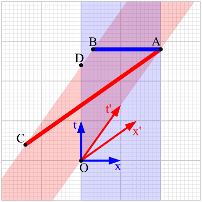

pervect said:
So, we conclude that the train is 10 feet long in our frame.
What happens in the train frame? The observer on the train agrees that the flash at the tunnel exit went off just as the front of the train was at the exit, and that the flash at the tunnel entrance went off just as the end of the train was there. But he denies that the two flashes occurred at the same time.
Neither person is wrong. In the train frame, the flashes did not occur at the same time, and the length of the train was 20 meters.
In the camera frame, the flashed did occur at the same time (simultaneity is relative!), and the length of the train was 10 meters.
Thank you pervect. This is the solution to all my questions.
(I actually had an idea of a ‘centralized unit’ in my OP to solve this puzzle)
Relativity of Simultaneity is the solution and explanation why a 20 meter train could fit in a 10 meter tunnel. Piece of cake!

pervect said:
There is a fairly simple experiment, originally due to Einstein, that shows that the length of the train, in some sense, "really" does vary.
