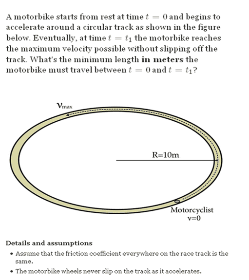

What is the maximum velocity of a motorbike on a curved track?

I am not sure which equations to start with here.
Let ##\mu## be the coefficient of friction.
The maximum velocity is attained when it is just about to slip i.e
[tex]\frac{mv_{max}^2}{R}=\mu mg[/tex]
where m is the mass of motorbike.
[tex]\Rightarrow v_{max}=\sqrt{\mu gR}[/tex]
Next I think I have to use the energy conservation but I don't know the force which helps the bike to accelerate. :confused:

I see friction playing a rôle in two places here. Below a certain speed it stops the cyclist sliding off the track, but it also limits him to a certain acceleration which if he attempts to exceed he'll spin his back wheel.
No, it is explicitly stated in the assumptions that the motorbike never slip as it accelerates
Pranav-Arora said:
... but I don't know the force which helps the bike to accelerate
It's the same force that let's you start walking from rest.

I don't think we want to assume constant tangential acceleration. Friction will allow only a certain maximum amount of net acceleration. As the motorbike speeds up, more and more of the acceleration will need to be centripetal, leaving less acceleration for tangential.

Yes, friction is the force. What is the magnitude of the maximum acceleration that the bike can have? How would you express this magnitude of acceleration in terms of tangential and centripetal components?
Maximum acceleration can be ##\mu g##?
It can be expressed as:
[tex]\left(\frac{mv_{max}^2}{R}\right)^2+(ma_t)^2=(\mu g)^2[/tex]
where ##a_t## is the tangential acceleration. Does this look correct?

The bike never slips. To reach the maximum speed in the shortest time, its tangential acceleration must be as high as possible. What does it mean for the tangential acceleration at any time?

at=dv/dt and v=ds/dt where s is the arc length travelled. If you know the maximum allowed tangential acceleration at any time you get the arc length by integration.
See if you can express at in terms of dv/ds rather than dv/dt. Here, s is distance traveled. That way you won't need to worry with time. The trick is to use the chain rule. Think of v as a function of s while s is a function of t: v = v(s(t)). dv/dt = ?

##a_t=v(dv/ds)##?

This one:
[tex]\left(\frac{v_{max}^2}{R}\right)^2+(a_t)^2=(\mu g)^2[/tex]
I think I am wrong about substituting ##a_t=v(dv/ds)## in this equation as it is only applicable for max acceleration. :confused:

You can always write ##a_c^2 + a_t^2 = a^2## at any time during the motion, not just at the time when you reach maximum speed. See what you get if you substitute ##a_t = v dv/ds## in this equation with ##v## not at max value.

Sorry, I replied hastily before.
[tex]\left(\frac{v^2}{R}\right)^2+\left(v\frac{dv}{ds}\right)^2=(\mu g)^2[/tex]
It can be rewriten as (I am substituting ##\mu g=k##)
[tex]\frac{dv}{ds}=\frac{1}{vR}\sqrt{R^2k^2-v^4}[/tex]
[tex]\frac{vR dv}{\sqrt{R^2k^2-v^4}}=dx[/tex]
Integrating v from 0 to ##v_{max}## and s from 0 to ##s_{min}##
[tex]\frac{R}{2}arctan\left(\frac{v_{max}^2}{\sqrt{R^2k^2-v^4}}\right)=s_{min}[/tex]
What should I substitute from ##v_{max}##? :confused:
  • #35
At ##v_{max}## what is the direction of the total acceleration?
