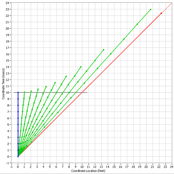

I'm not going to address all your points, some of them have already been addressed by others. I just want to show you how the Proper Time of an object traveling at some speed relative to you changes with speed and why we can't talk about the Proper Time for a photon. To do this, I have made a spacetime diagram showing you in blue and a bunch of green objects traveling away from you at different speeds, every 10% of the speed of light up to the last red object which is traveling at 99.9% of the speed of light. The speed of light in this diagram is one foot per nsec. I have drawn in a black line at the Coordinate Time of 10 nsecs so that you can easily see how far each object has traveled in that amount of time. You can see that they each travel 1 foot farther than the previous one.
The dots on each line show one nsec increments of Proper Time and I have shown ten increments for you (in blue) and for all the green objects but for the last one in red I have shown only one increment because if I had shown ten, the diagram would be ten times larger. If I had shown an object traveling at 99.99%c it would have had its first increment of Proper Time at 70 nsec and 70 feet. At 99.999%c these numbers would be over 223 and at 99.9999%c they would be over 707. As the speed of an object approaches that of light, the first increment approaches infinity so we don't want to make a drawing of an object traveling too close to it.
I have shown a photon as the thin red line extending out from the red object. Proper Time does not apply to it.
Any questions?
