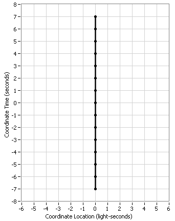

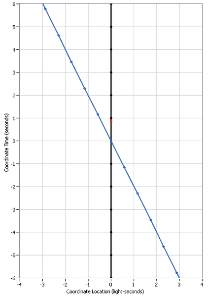

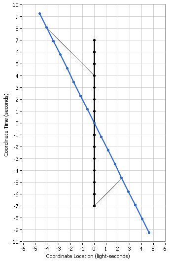

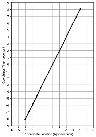

I'm going to show you how you can use the Lorentz Transformation to analyze your scenario from post #4:
Platformance said:
Suppose a spaceship travels past at 0.5c, the spaceship passes an observer on a planet.
Let's start in the rest IRF for the spacecraft :
The black dots represent one-second intervals of time aligned with the Coordinate Times starting at -7 seconds to +7 seconds. Each dot represents an event with both a time and a location coordinate (along the x axis).
Now we want to transform these events into the rest IRF for the observer on the planet. To do this, we will note that as far as the spacecraft is concerned, the planet is traveling to the left at 0.5c so we want to use v=-0.5c. I like to use units where c=1, in this case seconds and light-seconds. This allows us to use simplified equations based on β=v/c and β=-0.5. The equation for gamma is:
γ = 1/√(1-β2)
I already evaluated this in post #5 so I won't do it again:
γ = 1.1547
Now we have to use both Lorentz Transformation equations:
t' = γ(t-xβ)
x' = γ(x-tβ)
Note that on the right side of the equations there are no primed terms, they are both on the left sides. The way you use these equations is you pick an event in the original IRF and plug its x (location) and t (time) coordinates into the equations to calculate the x' and t' coordinates for the same event in a second IRF moving at β with respect to the original IRF.
So let's use the uppermost event with coordinates of x=0 and t=7. Plugging these values into the two equations we get:
t' = γ(t-xβ) = 1.1547(7-0) = 8.0829
x' = γ(x-tβ) = 1.1547(0-7*(-0.5)) = 1.1547(3.5) = 4.04145

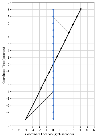

If we calculate the events for the bottom event we will see that it has the same values but they are the negatives.

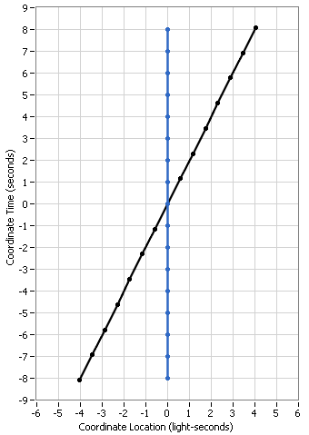

Now you could repeat the calculations for all the other events or you could just realize that the dots will be equally spaced in the new IRF and just mark them in if you are drawing a diagram by hand. I use a computer program so we will get:
As you can see, the dots representing 1-second intervals are spaced farther apart--they are dilated. We call the time for the spacecaft, the Proper Time of the spacecraft . For convenience, we will call the Proper Time when the Coordinate Time is zero to also be zero and count the dots upwards or downwards from that point accordingly to determine the Proper Time of any other dot.
Now since this is the rest IRF of the observer on the planet, we can just draw him in using blue for his color:
Now I think you can see that at the observer's Coordinate Time of 1 second, the Proper Time of the spacecraft is a little less than 1 second. This is where your calculation comes in.
The event (not shown by a dot) that you want to consider has coordinates of t=1 and x=0.5 and β is now 0.5 (because the spacecraft is moving to the right in the planet's rest IRF). You just plug those into the same two equations we used before and get coordinates of:
t' = 0.866
x' = 0
I previously did the calculation for t' in post #5 so I won't repeat it here and you can see that the x' value evaluates to zero (as it must since we are transforming to the rest IRF of the spacecraft ).

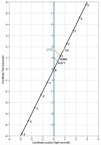

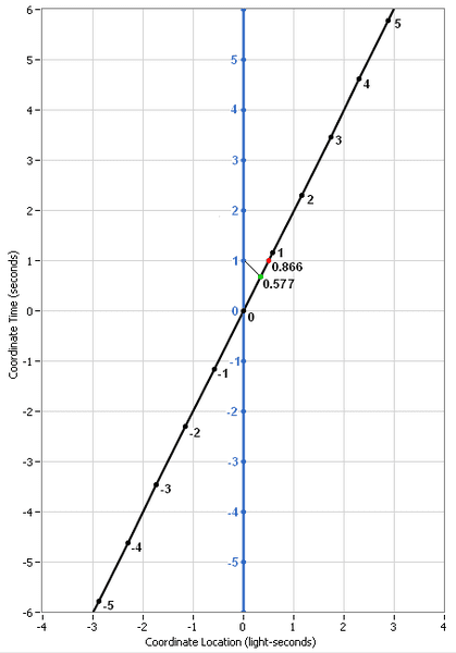

Platformance said:
Going back to the diagram with the spaceship example, the proper time in the spaceship is 0.866s, but I don't see 0.866 in the diagram. Is 0.866 the distance between 2 blue dots if the distance between 2 black dots is 1?
I think you may have the right idea, but you really should think in terms of the Coordinate Time, not the blue Proper Time for several reasons:
Firstly, the blue Proper Time applies just to the blue observer on the planet which remains localized at x=0 in this IRF, whereas the spaceship is only at x=0 for an instant in time (t=0). On the other hand, the Coordinate Time applies everywhere.
Secondly, the blue observer doesn't have to remain stationary, he could take off in his own spaceship at some high speed, in which case his own Proper Time world be dilated and no longer related to the Proper Time of the black spaceship.
Thirdly, we don't even need the blue observer as is the case in the second diagram in post #7.
Fourthly, we can transform to a different IRF in which both the blue observer and the black spaceship are traveling at new speeds with new gamma values and new time dilations with new spacings of the Proper Time dots which will always have the correct ratios with respect to the Coordinate Time.
So the Proper Time interval from t=0s to t=0.866s, is 86.6% of the vertical distance from the position on the graph of the black dot (which is obscured by the blue dot at the same position) to the next black dot upwards and occurs exactly at the Coordinate Time of 1s.

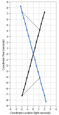

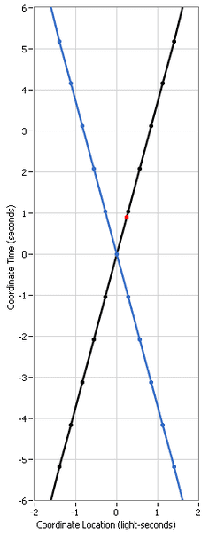

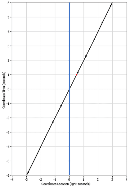

I have drawn a zoomed in diagram and added a red dot at the coordinates of t=1 and x=0.5:
Now I let my program redraw the diagram with β=0.5. This transforms the rest IRF of the blue observer on the planet to the rest IRF of the black spaceship:
Now the red dot has the coordinates that were calculated previously and I think you can see that it is 86.6% of the way from the Proper Time of 0s to the Proper Time of 1s for the black spaceship.
And, as I said earlier, we can also transform to any other IRF such as this one where both the blue observer on the planet and the black spaceship are traveling apart from each other at 0.268c:
Now you can see that both the observer and the spaceship are time dilated by the same amount (1.038) and yet the red dot is still 86.6% of the way from the dot at t=0 to the next black dot up. However, the red dot has no significance in this diagram--it doesn't represent anything except to show that it is at the same Proper Time for the spaceship. Note that the red dot is just below the Coordinate Time of 1 second while the black dot above it is above the Coordinate Time of 1 second. The whole point of this exercise is to make clear that Time Dilation is different in different IRF's and is unobservable by the observers on the planet or spaceship. No observer has any awareness of their own Time Dilation or the Time Dilation of any other observer. How could they? It changes when we choose a different IRF to represent the scenario.

The first signal I have drawn in starts at the black spaceship's Proper Time of -7s (you have to count the dots down from the dot representing 0s where the spaceship and the planet coincide) and it goes up and to the right to the blue observer's Proper Time of -4s. So the blue observer actually sees the clock on the spaceship displaying -7s when his own clock displays -4s.
Then when the spaceship passes him, he sees both their clocks displaying 0s. So he would say that he is seeing the spaceships clock ticking 7/4 or 1.75 times the rate of his own. This is called Relativistic Doppler and there is a formula to calculate it which you can look up in wikipedia if you want. That formula gives a more exact value of 1.732051 but this is close enough for simply eye-balling values off a diagram.
The second signal I drew in starts at the black spaceship's Proper Time of +4s and goes up and to the left to the blue observer's Proper Time of +7s. Now he would say that it appears that the spaceship's clock is ticking at 4/7 or 0.571 times the rate of his own. The formula gives about 0.57735.
So neither one of these ratios is the correct Time Dilation of 1.1547 for this IRF. However, if we average the two Relativistic Doppler factors that we measured or calculated, we would get the correct Time Dilation factor:
(7/4 + 4/7)/2 = (49/28 + 16/28)/2 = (65/28)/2 = 2.3214/2 = 1.1607
Or more precisely using the Relativistic Doppler formula values:
(1.732051+0.57735)/2 = 2.309401/2 = 1.1547
Now let's look at the rest IRF for the spaceship:
As you can see, the blue observer still sees the same comparative rates of the spaceship's clock and he makes all the same calculations but in this IRF, it is his own clock that is Time Dilated, not the spaceship's and so he gets the "wrong" answer. Or we could reinterpret what he is calculating and say that he is determining what the spaceship's Time Dilation would be in his own rest IRF even if we are analyzing the scenario from a different IRF.
Finally, let's look at the IRF in which both the observer and the spaceship are traveling at the same speed in opposite directions (0.268c):
Once again, all observations and calculations remain the same even though in this IRF the Time Dilations of the observer and the spaceship are identical.

@ghwellsjr,
Thank you for the great explanation! I've been trying to get this to work right in an Excel spreadsheet for years and thanks to you it finally works!
So the 0.866s represents a fraction of distance between the points for the black line and not the total distance, but the black dots are a distance 1.1547 away. Does this mean that when the planet's clock tick 1 second, the observer sees an event, but when the clock ticks 1.1547 seconds, the spaceship sees an event?
As for the 0.25s, I don't quite remember what my calculations were. However, I did the calculation by thinking that t = γ(t' + x'v/c2) was an expanded version of the time dilation formula since I wasn't quite sure what the equation meant. I thought the period of time dilation changed as one frame moved away from another frame.
Take a look at this diagram which is basically the same as the first one in post #13, except I have added labels to show the Proper Times displayed on the blue clock traveling with the observer on the planet and the Proper Times displayed on the black clock traveling with the spaceship:
So 0.866s (where the red dot is) represents the Proper Time on the black clock when it gets to the Coordinate Time of 1 second. The black dot at the Proper Time of 1 second is at the Coordinate Time of 1.1547s.
Platformance said:
Does this mean that when the planet's clock tick 1 second, the observer sees an event...
When the planet's clock ticks 1 second, the observer sees the event of his own clock displaying 1 second, and he also sees the spaceship's clock at 0.577s which is approximately 4/7, the same ratio discussed in post #14 after the first diagram.

Let's review:
Here is the first diagram I made for you from post #7 showing the rest IRF for the spaceship:
Note that the speed of the spaceship in this IRF is zero and therefore gamma is 1 and the Time Dilation factor is 1, which means that the spaceship's clock ticks at the same rate as the coordinate time. Even though the Proper Time on the spaceship's clock is the same as the Coordinate Time, we realize that they are not the same thing because the spaceship's Proper Time only applies at the location of the spaceship (where the thick black line is), while the Coordinate Time applies everywhere. We could pick any random point on the graph and we could specify an event with its Coordinate Location and Coordinate Time by looking at the corresponding grid lines (and interpolating if necessary).
Now the second diagram I made for you shows what you get when you transform the coordinates of all the events of the first graph to a speed of -0.5c:
You will note that the spaceship has a new speed, 0.5c, a new gamma, 1.1547, and a new Time Dilation factor of 1.1547. Therefore, speed, gamma, and Time Dilation factor are all coordinate effects--they depend on the coordinates of the IRF in which we are describing the scenario. You will notice that there is no clock in this IRF whose Proper Time matches the Coordinate Time but we do see that the ratio of the Coordinate Time to the Proper Time of the spaceship's clock has the correct Time Dilation factor.

The spaceship is traveling at 0.5c. Gamma at this speed if 1.1547. Since the ratio of the Coordinate Time to the Proper Time for the spaceship in this scenario is equal to gamma and since the Proper Time is 1, then the Coordinate Time is equal to the product of the Proper Time and gamma which is 1.1547.
Platformance said:
The observer does not see the spaceship clock at 1 when the coordinate time is 1.1547, but instead at coordinate time 1.732 (calculated using the relativistic doppler).
Correct. You can verify this by drawing a diagonal line at 45-degrees going from the event of the spaceship's clock at 1 upward and to left until it intersects with the planet's clock.
Platformance said:
Finally, the proper time of the spaceship when the coordinate time is 1.732 is 1.12 (calculated using time dilation).
This is not correct. You can get from Coordinate Time to Proper Time in this scenario by dividing by gamma so it would be 1.732/1.1547 = 1.5. How did you get 1.12?
I have added lines into the drawing from post #17 to show the issues on this post:
