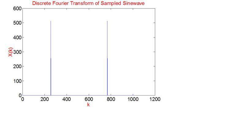

so this is from math lab
x is a 2 kHz sinewave
>> n = 0:1023;
>> t = n/8000;
>> x = sin(2000*2*pi*t);
>> X = fft(x);
>> plot(n,abs(X));
I have uploaded the picture of the graph ...
but is it wrong
2000 is the only one that should have a real value right ?
I think it is correct. The Fourier transform of sin(a t) is a sum of two Dirac deltas up and down from the base frequency a. Your plot shows the discretization of those deltas at 1/4 and 3/4 of the range.
I imagine this sounds confusing because the sine is a "pure tone" and the power spectrum should have only one peak. The power spectrum of a real signal is an even function, so in practice one only needs to show half of the spectrum, and it is that half that has one peak.
Likes 1 person
Looks reasonable to me. recall [itex]sin(x)=\left( e^{ix} - e^{-ix} \right)/2i[/itex], so a real sinusoid will have both a positive and negative frequency component. You should be able to compute which frequency bins correspond to +/- 2000 Hz, given your sample rate and the number of time samples you used.

so when someone does F(t) = sin(2000*2πt);
there are really two frequencies : one positive and one negative?
So is 2000 not really the real frequency ?
if so what are the real frequencies and how do you solve for them?

As I showed above, a real sinusoid of frequency 2000 Hz has a DFT with peaks at +2000 Hz and -2000 Hz. To map the bins of the FFT output to frequency depends upon the particular FFT software you are using (different packages pack the positive and negative frequencies differently). I do know that for matlab, the first N/2 are the positive, and the next N/2 are the negative. There is a command fftshift that makes 0 frequency (DC) the middle bin. So in matlab, for your example, you can plot
>> fs = 8000; %your sample rate
>> N = 1024; %the number of samples you are using
>> F = fs*[-N/2:1:N/2-1]/N;
>> plot(F, abs(fftshift(X)));

Yes, see my example above with sin(x). The DFT is essentially expanding your input signal in a series of complex sinusoids. So a signal that is exp(i w t) can be represented by a signle complex exponential, while sin(w t) is a combination of exp(i w t) and exp(-i w t), so needs two of the complex exponentials to represent it.

Note that you should be dividing by 1024 (the number of samples) instead of 1023. Also, do your indices in your code start with 0 or 1. That is, is the first frequency bin F[0] or F[1] ? If it is F[0] (which I suspect since C starts arrays at element 0) then the peak at F[256] means the frequency corresponds to
(256/1024)*8000 = 2000 Hz exactly, and the other peak is at
(768/1024)*8000 = 6000 Hz exactly.
In any case, I will let you sort out indexing and such.
Since you are sampling at 8000 Hz, your Nyquist is at 4000 Hz, hence your 6000 Hz really corresponds to 4000-6000 = -2000 Hz. This is the negative frequency part of your sinusoid. There is nothing wrong here, and it is unambiguous how to interpret your fft output. Again, what you are doing with your Fourier analysis is representing your initial time-domain signal as a finite sum of complex exponentials; the DFT is the way you compute the coefficients of that expansion (and the FFT is simply an algorithm that performs the DFT in a smart way to minimize computation). Since your signal is effectively sin(x) you expect to see both a exp(ix) and exp(-ix) term. If your input signal was simply exp(i*2*pi*2000*t) then you would only get a single peak instead of 2 peaks. You should try it and see!
