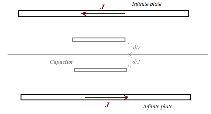

So, I think you need to assume that the B field does not really extend to infinity in all directions. For example, you could take the B field as being produced by two infinite parallel plates oriented parallel to the capacitor plates as shown in the figure below. Each infinite plate carries a uniform current density J so as to produce a uniform B field out of the page between the infinite plates. The capacitor is placed symmetrically between the infinite plates. B is decreased by letting J decrease. For this geometry, you should be able to deduce the direction of the induced E field. Try to show that the direction of the induced E-field is parallel to the plates. There is no component of induced E field perpendicular to the capacitor plates.

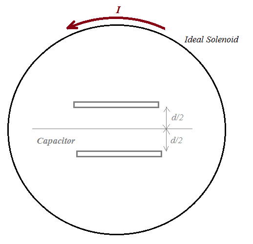

Or, you could use a large, ideal solenoid to produce the B field out of the page. See the other figure. B is decreased by letting the current I in the solenoid decrease. You should now be able to show that the induced E-field lines are circular. You can work out the force on the capacitor plates due to this induced E-field and show that you get the same result for the force as for the infinite plates configuration.

To obtain specific solutions to the differential equations, you have to impose additional constraints on the fields such as boundary conditions or other conditions associated with the geometry.
For example, consider the case I gave earlier where the B field is produced by two current-carrying, infinite plates oriented parallel to the xy plane. The B field is invariant under any translations parallel to the xy plane. So, it seems to me that the induced E field produced by changing the magnitude of B would also have to be invariant under translations parallel to the xy plane. That is, the induced electric field cannot depend on x or y. So each component of E is a function of z only. (This argument might be too hand-wavy. Hopefully, someone will point out if its wrong or if there is a more rigorous argument.)
So, if you accept that the components of E are functions of z alone, see what you can deduce from your differential equations. You might also want to see if ##\vec{\nabla}\cdot\vec{E} = 0## give you any information.
