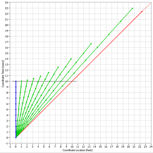

A vertical line represents an object that is stationary in the frame. That's because its x coordinate doesn't change as its t coordinate does change. A slightly off vertical line represents an object moving at a slow speed (either positive or negative). A line with a lower slope represent a faster moving object. Just don't go as low as a 45-degree diagonal.
I like to depict the passage of time for a moving object as a series of dots, each one marking a unit of time. This is called Proper Time. For a vertical line, the dots are spaced the same as the coordinate time. For lines that are sloping off the vertical, the dots get farther apart. Here is a spacetime diagram to illustrate what I have been talking about:
The dots on each line show one nsec increments of Proper Time and I have shown ten increments for you (in blue) and ten increments for all the green objects but for the last one in red I have shown only one increment because if I had shown ten, the diagram would be ten times larger. If I had shown an object traveling at 99.99%c it would have had its first increment of Proper Time at 70 nsec and 70 feet. At 99.999%c these numbers would be over 223 and at 99.9999%c they would be over 707. As the speed of an object approaches that of light, the first increment approaches infinity so we don't want to make a drawing of an object traveling too close to it.
I have shown a photon as the thin red line extending out from the red object. Proper Time does not apply to it.
Does that answer your question?
EDIT: The green objects are traveling at successively faster speeds. The first one, next to the blue one is traveling at 0.1c. You can tell that because in 10 nsecs, when it crosses the thin black line, it has traveled 1 foot and since light travels at 1 foot per nsec, the green object is traveling at 0.1c.
When the second green line crosses the thin black line, it has traveled 2 feet and so on until we get to the ninth green line which has traveled 9 feet in 10 nsec.
The thick red line is for an object traveling at 99.9% of the speed of light with only one increment of time.
I could have drawn another set of lines going off to the left to represent negative speeds but I think you can get the idea from just the positive ones, correct?
I don't think the equation for calculating the spacing of the dots at different speeds is complex and if you're interested, let me know and I'll show it to you. HINT: it's called gamma.
Any questions?

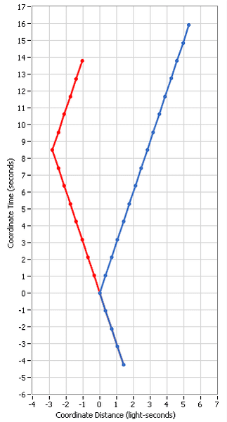

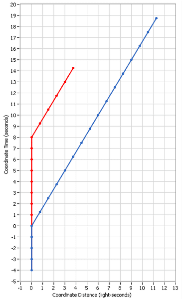

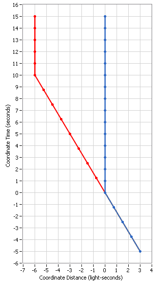

If I take your expression that "they would both have the same frame of reference again" to mean they are both at rest in the same frame of reference, then their times will not be synced, assuming that you mean what is normally meant by "synced", namely that their clocks are synchronized according to Einstein's convention.
Let me show you what I mean with some spacetime diagrams. The first one shows the original common rest frame for the two objects (prior to time zero, both objects are at the same place so only the blue one shows up but realize that the red one is also present there):
The dots represent intervals of one second for each object. They have both reset their clocks to zero at the coordinate time of zero. As soon as the blue object accelerates away from the red object, his clock slows down and the two clocks are out of sync since they are ticking at different rates. Now after the red object accelerates to the same speed as the blue object, their two clocks tick at the same rate but they remain out of sync. For example, at the coordinate time of 13 seconds, the red clock is at 12 seconds but the blue one is a little less the 10.5 seconds. You will have to count the dots from time zero to see this.
Now we transform the original spacetime diagram to the mutual rest frame at the end of the scenario:
At the coordinate time of 13, red's clock is at 11 and blue's is at 13. They are obviously ticking at the same rate but they are out of sync.
There is a frame that we can depict the scenario in for which the two clocks will remain in sync from start to finish and that is one in which the two objects are always traveling at the same speed of 0.333c but they change their directions when they accelerate:
At the coordinate time of 13, they both are at just over 12.

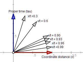

No, you can't travel on a line at any positive slope, the slope must be greater than 1 (and it can also be more negative than -1). It just can't be 1 because that is the speed of light and slopes smaller than that would be faster than light.
I think what adimantium had in mine, was something like the example given by Brian Green that an object that is stationary relative to us, has motion entirely in the 'time' direction (in 4 space) and a particle that is traveling at the speed of light has motion entirely through space. In the 4 space chart, for any positive proper time interval and any positive spatial interval, positive slopes of greater than 1 are allowed.
In the above diagram, the blue vector represents an object that is stationary (in 2 space) moves only in the proper time direction. The black vectors represent objects with timelike velocities that have 4 velocity components in both the proper time direction and the space direction. The red vector represents a photon that travels entirely in the space direction and has a zero proper time component.
The stationary object has zero velocity in 3 space, i.e. dx/dt = 0 but its velocity in 4 space is dtau/dt = c. The magnitude of the 4 velocity of all the particles is in fact also c, and it is only the direction (through proper time or space) that changes.
