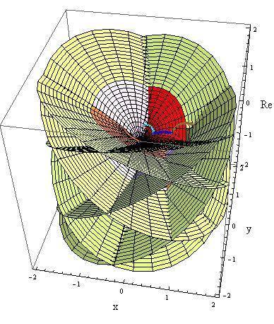

Here's the Pochhammer plot and the homologous contour you described above:
http://img191.imageshack.us/img191/1373/zr2z.jpg
I begin the integration on the blue segment which I will place over the principal branch of the function in which case we can write in the limit as the indentations go to zero:
[tex]\mathop\int\limits_{\text{blue}} f dz=\int_0^1 f(x)dx[/tex]
We then continue around the contour along the indicated path and I obtain:
[tex]\mathop\int\limits_{\text{blue}} + \mathop\int\limits_{\text{purple}}+ \mathop\int\limits_{\text{red}}+\mathop\int\limits_{\text{green}}[/tex]
and as we go around the intented contours, the function values can change by either [itex]e^{\pm 2n\pi i a}[/itex] or [itex]e^{\pm 2n\pi i b}[/itex] so that if I carefully choose the branches I integrate over, really at this point just contrive it to get it to work, we accumulate factors of [itex]e^{2n\pi i a}[/itex] or [itex]e^{2n\pi i b}[/itex] and so can write the integrals as:
[tex]\int_0^1 f+e^{2\pi i b} \int_1^0 f+e^{2\pi ia}e^{2\pi ib} \int_0^1+e^{2\pi i a}e^{2\pi ib} e^{-2\pi i b} \int_1^0 f[/tex]
[tex]\left(1-e^{2\pi i b}\right) \int_0^1 f+e^{2\pi i a} e^{2\pi i b} \int_0^1 f-e^{2\pi i a} \int_0^1[/tex]
[tex]\left(1-e^{2\pi i b}\right)\int_0^1 f-e^{2\pi i a}\int_0^1 f\left(1-e^{2\pi i b}\right)[/tex]
[tex]\left(1-e^{2\pi i a}\right)\left(1-e^{2\pi i b}\right)\int_0^1 f=\int_P fdz[/tex]
[tex]\left(1-e^{2\pi i a}\right)\left(1-e^{2\pi i b}\right)\beta(a,b)=\int_P fdz[/tex]

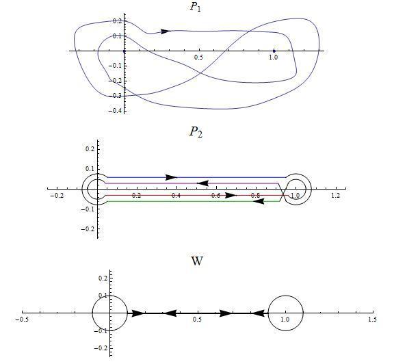

The following three forms of the pochhammer contour are useful. The four horizontal paths along the real axis over the ##P_2## and ##W## contours are over different determinations of the function:
Consider the computation of ##\beta(\alpha,\beta)## with ##\alpha=3/2## and ##\beta=4/3## using the pochhammer integral
$$\int_P z^{1/2} (1-z)^{1/3} dz=\int_P fdz.$$

We now go back to the ##P_2## contour and begin the analysis of computing ##\Delta \text{arg}## of the function as we proceed around the contour beginning at the point ##z=1/10## and for that analysis, we write the function as:
$$f=|z|^{1/2}e^{i/2(\theta_p+2n\pi)}|1-z|^{1/3}e^{i/3(\theta_q+2k\pi)}, \quad n=0,1,\quad k=0,1,2$$
with ##\theta_p=\text{Arg}(z),\quad \theta_q=\text{Arg}(1-z)## and ##-\pi<\text{Arg}(u)\leq \pi##. In this particular case, we wish to begin the integration of the principle value of the integrand over the blue contour which in the standard order above is the determination identified by ##w_2##. As we proceed along the blue contour, the argument does not change. At the point ##x=9/10##, we begin around the circular arc with ##z=1+\rho e^{it}## as ##t## varies from ##\pi## to ##-\pi##. The argument of the first term does not change, however, the mapping of ##(1-(1+\rho e^{it})## as t goes around this circle is a circle contour around the origin going in a clockwise direction beginning at ##\rho##. When ##t=0## we have for the second term ##e^{i/3(-\pi)}## and for the path to be analytically continuous across the negative real axis, we must join the current branch with the branch ##e^{i/3(\theta_q+4\pi)}=e^{5\pi i/3}=e^{-\pi i/3}## and therefore we have ##e^{4\pi i/3}f## for the value of the integrand along the purple contour. Again, the argument does not change along the horizontal leg of the contour. At the point ##z=1/10##, we now consider the argument change of ##z^{1/2}##. We then have ##e^{i/2(\theta_p+2n\pi)}##. As we go around the circular leg in a counterclockwise direction, we reach the point ##z=-1/10## and have ##e^{i/2(\pi)}## and similar to the above, in order to maintain analytic continuity around the contour, we join the current branch with ##e^{i/2(\theta_p+2\pi)}=e^{i/2(-\pi+2\pi)}=e^{i/2(\theta_p+2\pi)}## and proceed to the orange contour at which point we now have ##e^{i/2(2\pi)}e^{i/3(4\pi)}f##. We do similar analyses along the entire contour and then consider the limit as the radius, ##\rho## around the two singular points approach zero. We are then left with the horizontal legs and have$$\begin{align*}
\lim_{\rho\to 0}\int_{W_2} fdz&=
\int_0^1 f-e^{4\pi i/3}\int_0^1 f+e^{2\pi i/2}e^{4\pi i/3}\int_0^1 f-e^{2\pi i/2}e^{2\pi i/3}e^{4\pi i/3}\int_0^1 f\\
&=\left(1-e^{4\pi i/3}\right)\int_0^1 f+e^{2\pi i/2}e^{4\pi i/3}\int_0^1 f-e^{2\pi i/2}\int_0^1 f\\
&=\left(1-e^{4\pi i/3}\right)\int_0^1 f+e^{2\pi i/2}\left(e^{4\pi i/3}-1\right) \int_0^1 f\\
&=\left(1-e^{2\pi i/2}\right)\left(1-e^{4\pi i/3}\right)\int_0^1 fdz

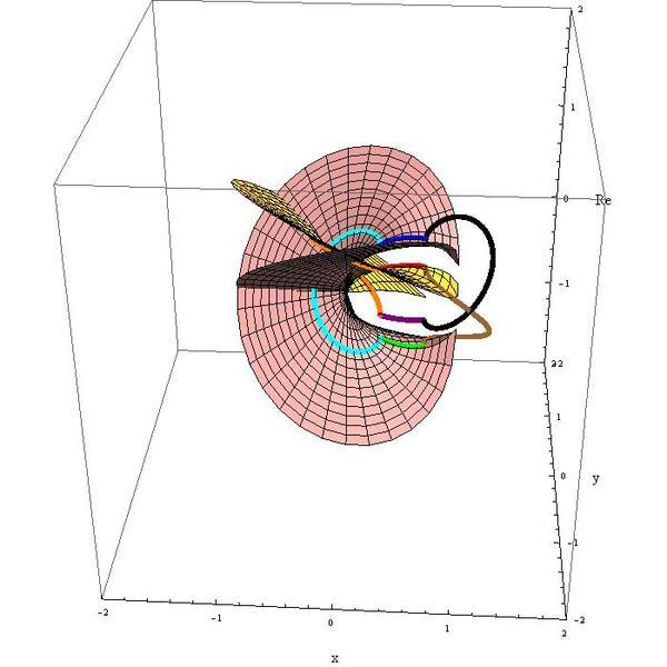

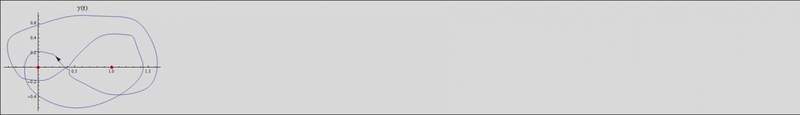

Before going further with this analysis, I thought it would be helpful to ground the reader in the actual integration path of this problem. The pochhammer contour is unusual in that it is not a simple contour like the common contours studied in basic complex analysis. Just looking at the three diagrams above does not give the reader a sense of what actually is being integrated. The figure below shows explicitly, one of six ways the contour worms through the real component of the function ##z^{1/2}(1-z)^{1/3}##, a different determination of the function being traversed over the horizontal blue, green, red and purple legs. In this particular case, the start of integration, blue, is pinned on the principle value of the function; if you just plotted the function ##f(x)=x^{1/2}(1-x)^{1/3}##, for ##(0.3,0.7)##, the resulting plot would be the same as the blue contour.The figure only shows a small part of the function's total coverings in order to see more clearly how the pochammer contour winds through the various sheets. The full real component of the function for ## |z|\leq 2 ## , for those interested, is shown in the thumbnail below. If you click on it, you can just barely make out some of the contour embedded deep in the twisted sheets of the function.

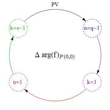

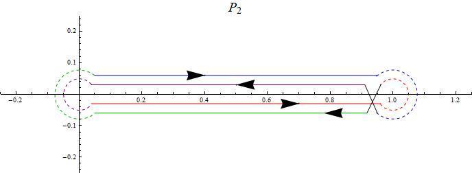

Over the red-dashed contour, we have
$$e^{2n\pi ip/q}=e^{2\pi ip/q+jk\pi i}$$
$$np=p+jq$$
$$n-1=jp/q$$
and so again, we let j=0 so that ##n=1## is the new branch number.
On the final contour:
$$e^{2k\pi ir/s}=e^{-2\pi ir/s+2j\pi i}$$
or:
$$kr+r=sj$$
$$k+1=sj/r$$
we again let j=r so that k=s-1. These argument changes are depicted in the following plot.
It shows that traversing over the blue-dashed contour changes the branch to the ##n=q-1## branch. As we next go around the purple-dashed contour, the branch changes to the ##k=1## branch and so forth around the contour.
For ##w=z^{r/s}(1-z)^{p/q}##, we then have over the principle contour:
$$\int_0^1 f+a\int_1^0 f+ab\int_0^1 f+abc \int_1^0 f$$
where ##a=e^{2\pi ip/q(q-1)}##, ##b=e^{2\pi ir/s}##, and ##c=e^{2\pi ip/q}##.
or:
$$(1-a)(1-b)\int_0^1 fdz=\int_{P(0,0)} fdz$$
or:
$$\left(1-e^{2\pi i\alpha}\right)\left(1-e^{-2\pi i\beta}\right)\beta(\alpha,\beta)=\int_{P(0,0)} z^{\alpha-1}(1-z)^{\beta-1}dz$$
where the ##P(0,0)## signifies that we are pinning the starting branch, blue, on the principle branch or k=0 and n=0 branch.
