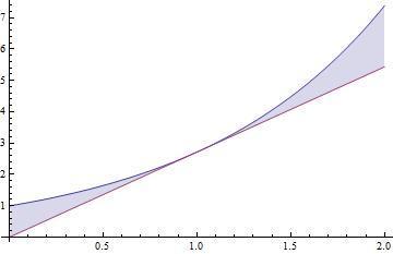

How about ##e^x##? Won't that work for starters? Worry about the others later if we can just do that one. Then from what you said, I constructed an example for r=1 in the plot below and looks like we need the area of the blue right? If that's so, then it's not hard to find an equation of that tangent line as a function of r right? Once we get that line and we know the function, then we can compose the integral for the two shaded regions as a function of r.

Thanks for replying! I think I was able to solve for the area for e^x. I integrated f(x)= e^x from 0 to a and got F(x)= e^a-1. I then solved for the tangent line. I think it is f(x)- e^r=(e^r)(x-r). I then have to integrate the difference right? After integrating the difference from 0 to a, I got Area= (e^a) - [(e^r)(a^2)]/[2] - re^r(a) + ae^r - 1. Does this look right?

I don't think working with ##e^x## is very instructive. You need to start by writing the integral for the area in the general case. You can write the equation of the tangent line at ##(r,f(r))## since you also have the slope ##f'(r)## there. Do that and show us the integral you set up for the area.

You have a sign wrong. The integral should be$$
A=\int_0^a f(x)-f'(r)(x-r) - f(r)~dx$$which is a function of ##r##. Now calculate ##A'(r)## assuming you can differentiate under the integral sign, and remembering you are differentiating with respect to ##r##, not ##x##, and set it equal to ##0## looking for a critical point. So you will have integral(something)dx = 0. Now work out that integral remembering the variable is dx and see if you can solve the problem.
