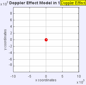

Stationary ([itex]M=0[/itex]):
Subsonic ([itex]M<1[/itex]):
Sonic ([itex]M=1[/itex]):
Supersonic ([itex]M>1[/itex]):
where [itex]M[/itex] is the Mach number.

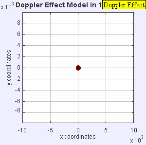

[PLAIN]http://upload.wikimedia.org/wikipedia/commons/e/e4/Dopplereffectsourcemovingrightatmach1.4.gif[/QUOTE]
This illustration shows a shock wave system made of shock waves propagating spherically; in particular, it shows a spherical front propagating backward, which I have been talking about.
There is never and will never be a shock wave in the rear of the moving point source, as those waves are not actually "piling up".
You misunderstand what "shock wave" means. To quote Wikipedia: "Shock waves are characterized by an abrupt, nearly discontinuous change in the characteristics of the medium. Across a shock there is always an extremely rapid rise in pressure, temperature and density of the flow". It has nothing to do with "piling up", nor with "breaking of finite-amplitude waves".
To me, it shows sound waves propagating spherically. So yes, you will hear sound behind the object. Just as you do when the object is slower than sound.
A single spherical front propagating backward? Where?
No, the blue circles are not shock waves. They are infinitesimal-amplitude sound waves. When they all coalesce at the front, that is where the shock wave forms. Imagine the blue lines as the peaks of a sinusoidal sine wave if it helps. Behind the source they have a lower frequency and in front they have a higher frequency. When the source reaches the speed of sound, the peaks in front have infinite frequency (zero period) and sit on top of each other, forming a shock.
Yes, this is the key point here. They are sound waves propagating spherically, not shock waves.

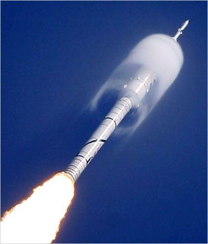

Here are two images that might assist in the conversation.
This first onet shows shockwaves originating from trailing edges of a missile. So shockwaves are not limited to areas that are more obviously compressed by the missile geometry.
http://quest.nasa.gov/aero/events/mars/picture2.jpg
This second one shows a shockwave triggered from a rocket launch. If you've seen videos of rockets passing through the right kind of atmospheric conditions, you have seen a variety of shockwave patterns evolve as the rocket accelerates through higher and higher Mach numbers.
What I don't ever remember is a sonic boom being picked up by the microphones at the launch site.
A typical launch vehicle goes supersonic at 7-8 km altitude. It is off sideways by a few km, too. I do not think a shock wave can propagate that far.
