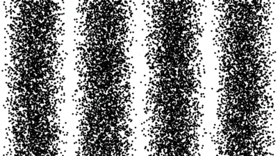

How does the pilot wave theory explain the double slit experiment?
In summary, the conversation revolved around the pilot wave theory and its explanation of the double slit experiment in quantum mechanics. The theory proposes that the pilot wave determines the probability of different possible paths for a particle, and the act of determining which slit the particle traverses affects the wave. The theory also has three assumptions: the pilot wave behaves deterministically, particles have definite positions influenced by the pilot wave, and there is a random distribution of initial positions. The discussion also touched on the idea that the measurement apparatus affects the pilot wave and the existence of interference patterns in the experiment. Ultimately, there was debate about whether Nobel laureate Richard Feynman's analysis of the experiment was correct and how Bohmian mechanics explains the interference patterns.
Filmmakerdoc
Hi,
I'm not a scientist, but a documentary filmmaker doing research on the nature of reality. An essential disclaimer as my question might seem a bit superficial to most you guys who work in the field.
I would like to know how the pilot wave theory to quantum mechanics explains the double slit experiment. Shouldn't the pilot waves behave the same in the presence or absence of measurement?
Thanks you
Ben

The idea is that the pilot wave traverses both slits, producing the interference pattern while the particle rides along it going through one or the other slit. The pilot wave determines the likelyhood of different possible paths.
The act or determining which slit the particle traversed has to affect the wave too.
The de-Broglie-Bohm (pilot wave) approach uses fancy non-intuitive maths (re: conditional wavefunctions) to describe this. Wikipedia has a summary.

I think the OP asked how dBB explains disapperance of the interference pattern when we try to check which slit the particle flied through. Does the measurement disturb the pilot wave?
It would be even more interesting with delayed experiments. We put a measurement apparatus over one of the slits then let the double-slit experiment happen. The apparatus checks if the particle flied through the slit, but we don't look at the outcome. Now the interference pattern should appear or disappear depending whether we decided to look at the indication of the apparatus, even if the particles apparently already hit the screen.
How dBB explains existence and disapperance of the interference pattern in the double-slit experiment dependent of the observer's knowledge of the particle trajectory?

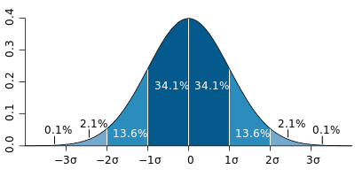

How can that be? With one slit open we will get the bell curve of normal distribution:
And of course, this is very different from the distribution of interference, so how can you say that we know the final position of each particle?? We don't!
This can be understood even with classical physics, so it should be easy. The fact that it confuses you suggests that you might have some problems with the relation between classical mechanics (which is deterministic) and classical statistical mechanics (which talks about probabilities).
Instead of giving you an answer, I challenge you to try to answer your own question by yourself, by using only classical physics. In any case, Bohmian mechanics cannot be properly understood without first understanding the relation between classical deterministic mechanics and classical statistical mechanics.
