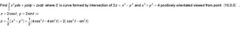

Here is my task and my attempt of solution:
How to use fact that C is positively orientated viewed from point (10,0,0)? I'm not sure I understand it.
Me neither. Perhaps it meant (0,0,10). I would just work it going either direction for ##\theta## and see what happens.

Is C supposed to be a closed path ?
It's closed alright. Here's a picture of it:

Yes the intersection makes a complete loop, but if the instruction is correct regarding the view from (10, 0, 0), then only part of that path is oriented in a positive direction.
That's why I asked (the OP) if the path is supposed to be closed. If so then the point (10, 0, 0) is incorrect as you have suggested.

It's (10,0,0) point, I didn't make mistake... I'm still uncertain about solving this problem...
I forgot to write, result is pi.

I think you had best ask your Teacher to clarify. It makes sense to talk about clockwise or counterclockwise orientation if you look down at it along the ##z## axis, but not from out the ##x## axis. And I don't see any interpretation of the problem that gives ##\pi## for the answer. Are you sure you copied the integral itself correctly?
