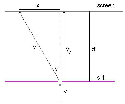

This is where you need to describe the SCENARIO in which you made the measurements. It makes a difference in QM, because QM is all about CONTEXT!
If I have just ONE particle, let's say I want to measure its position. What do I do? In QM this makes a boatload of difference on HOW you measure something. I can, for example,make it pass a very tiny slit, so that when it pass through it, I know that it had that position. Call this position x1, and the uncertainty in that position is Delta(x), corresponding to the width of the slit.
Now, there's nothing to prevent me from measuring, as accurately as I want, the momentum px AFTER it passes through the slit. How do I measure this? I can do that by
(i) putting a detector/screen after the slit;
(ii) measure the location that the particle hit the detector/screen;
(iii) measure how much it has moved transversely (i.e. in the x-direction) when it was moving from the slit to the screen)
(iv) calculate the x-component of the momentum since I know the speed that this particle moves and its mass;
(v) include the detector uncertainty that will give me the uncertainty in the momentum that I just measured. I will provisionally call this DDelta(px) - the double "D" is not a typo.
Now, I've just demonstrated that, in this case, I had just measured both position, and the corresponding momentum, to arbitrary accuracy limited by my instrument. In fact, I will argue that those two uncertainties (the Delta's) have no correlation with each other at all! I can increase the detector's accuracy, say by reducing the cross-talk between each of the detector channel, and thus, make the "spot" that I see on the detector or screen smaller, thus reducing the momentum uncertainty. This has ZERO effect on the width of the slit that I had the particle passed through.
So I've just showed you a way to measure position and momentum of a particle, and the HUP doesn't come into play... or does it?
What if I shoot a SECOND identical particle with the identical initial condition, at the identical slit? THIS is where it gets interesting!
After passing through the slit, do you think the particle will land on the detector at the same location? Classical mechanics will say that it should. After all, all the conditions are the same. But this is not true in quantum particles and in a quantum system.
Where the particle will land depends on how small the width of the slit is, i.e. how small Delta(x) is! The smaller Delta(x) is, the LARGER the spread in where the particle will hit the detector/screen. Remember, this also means that there will be a larger spread in the value of the momentum of the particle after it passes through the slit!
To know the nature of this spread, you have to send many more particles through the slit. It is ONLY when you have a statistically significant number will you see that there is a "central" value of the most probable momentum, and there is a spread (similar to the Standard Deviation in statistics) in the value of the momentum. Now this spread in momentum IS the "Delta(px) in the HUP!
So what does that tell you? You can't get the HUP from just ONE single measurement of x and px. If you look at the definition of the HUP, you'll see <x> and <p> and <x2> and <p2>. These are averages, which makes very little sense when you make just ONE measurement of each! So the uncertainties here is the SPREAD in the values that one would have upon REPEATED measurement of the identical system.
Secondly, it also tells you how well you can predict the outcome of the next measurement. The smaller the slit width, the less likely you will be able where the next particle will hit the screen. In other words, your uncertainty of the momentum will be larger with smaller slit!
This, in essence, is the HUP, and I had just described to you the single-slit diffraction.

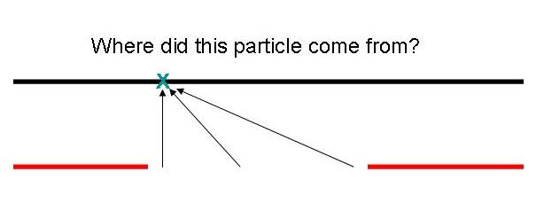

So if the screen and slit are near, and I have accurate positions of the particle at the slit and at the screen, then I can assign an accurate momentum to the particle along its entire trajectory using the classical equations, since the classical equations hold, right? Let's call this the single particle momentum.
However, we also know that when the screen is near the slit, the ensemble of single particle momenta obtained this way does not accurately reflect the momentum distribution we expect for an accurate momentum measurement of the wave function at the slit.
So would you say here we have accurate single particle momenta (since the classical equations hold, and we have two accurate position measurements), but the ensemble of these accurate single particle momenta are not accurate momentum distributions?
Think about this: what is the difference between a slit of width 1 micron, and a screen placed 1 micron away, versus a slit of width 1 meter, and a screen placed 1 meter away?
Can you get accurate momentum spread and momentum information out of that? Or did you just make Δx so big that there are no more momentum spread to be had?

Of course the momentum distribution when the screen is near the slit is not accurate. But the position measurements on the screen can be accurate whether or not the screen is near or far. Since there are two accurate positions - one at the slit and one at the screen - then if the classical equations hold near when the screen is near, I should be able to use them to get an accurate measurement of the single particle momentum.
No you can't, because if it is too close, the particle can come from ANY part of the slit! You now have an ambiguous origin on how to calculate your classical trajectory!
You have no way of assigning a unique momentum to that spot on the screen anymore!
Zz.
I see. And as the width of the slit gets smaller, the state at the slit is closer and closer to a position eigenstate, then even for any finite distance, the momentum will become more and more accurate. So is your basic argument that if we do know the particle is in an eigenstate of one observable, we can make simultaneous accurate measurements of non-commuting observables on it, because we can measure one observable without disturbing the eigenstate, leaving the same state available for a measurement of the non-commuting observable?

OK, I didn't realize this is that difficult to understand, considering that this is almost first-year physics.
v is known, since you can prepare the particles to be of a certain speed/momentum, or in the case of light, this is c.
The time taken for the particle to go from the slit to the screen is
t = d/vy = d/(v cosΘ)
For most cases, the slit is very small, and the screen is very far, so cosΘ ≈ 1 is a good approximation.
In that same time, the particle has a transverse x-component movement, which means that it has a transverse velocity/momentum, i.e.
vx = x/t = xv/d.
Since v and d are know, this means that knowing x, i.e. where it landed on the screen transversely, give you the velocity, and thus, the momentum.
I've done this for a non-relativistic case, since this gives a clearer illustration how we detect momentum in practically ALL cases. Note that you cannot detect "collision", i.e. you don't measure it. You measure where the colliding particle landed at detectors, and via reconstruction, you arrive at the momentum. This is how we measure energy and momentum of particles in high energy physics. We DETECT where the particles are when they hit the detector. All we see are locations of these particles at the detector. We do NOT see a "collision"!
Zz.
