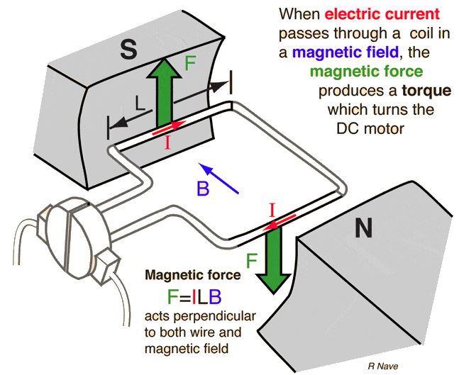

I find this almost impossible to describe without images.
In a simplified dc motor:
and given your initial parameters:
12 vdc
10 amps​
We can see that we can't really solve the equation: F=ILB
F being the force on the wire in Newtons
I being current in amps
L being length in meters, of the motor winding perpendicular to the flux field
B being the flux field strength in tesla
But one thing we can tell is that the motor is going to start rotating.
There is another equation: emf = vBL sin θ (ref)
which describes what happens when a conductor is pushed through a magnetic field.
emf being the voltage generated
v being the velocity of the conductor through the magnetic field
B & L were defined above
sin θ being the angle of motion of the conductor in relation to the magnetic field​
Now in the illustration that Hyperphysics has graciously provided, the angle θ changes constantly. But in real world dc motors, there are multiple loops of wire in the rotor, keeping the angle at relatively close to 90°. So the equation reduces to: emf = vBL
If you were to make up some numbers to to fill in the missing variables, you can actually calculate how fast your motor will run under no load, ideal textbook conditions, which would be when your emf generated, equaled the voltage supplied.
If c-emf didn't exist, the implications of F=ILB, would be disastrous, for an unloaded motor.
For F=ma, and if the current didn't reduce because of the c-emf, the motor would accelerate, until it disintegrated.
