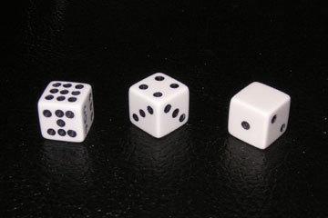

Took me a while*, but here are my alternate 3D6s:
1 2 2 3 3 4
0 1 2 3 4 5
2 4 5 6 7 9
*(a lot longer than my stupidhead friends appreciate... :mad: )
Bah, I can't seem to view your image. So you made some dice? Out of what?
