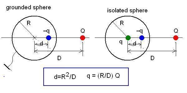

Image charges method point is: For the Laplace equation (ΔV=0), solution outside charges is unique. So if with placing image charges in smart places you can create the same symmetry, etc. as with the conductors with induced charges, you have THE solution.
Here you create an equipotential sphere with radius R by placing a smaller mirror charge on the symmetry axis. There are two unknowns (amount and position) and if sphere is uncharged, intersection points with the symmetry axis give two reasonable equations to find them.
In case of two charges, Q and -q, there is a sphere where the potential is zero.
The opposite is also true. If you have a grounded conducting sphere of radius R and a charge Q outside at distance D from the centre of the sphere, the potential is zero on the sphere and the electric field outside the sphere is the same as if there was a -q charge at the position shown, at distance d=R2/D from the centre of the sphere and q=RQ/D.
In case the sphere is isolated, the sphere is neutral. There is induced negative charge distributed on the outer surface and equal positive charge distributed on the inner surface: The effect of this inside charge distribution is the same as if a positive charge q was at the centre of the sphere. The electric field and potential outside the sphere is the same as that of these three charges: Q, the mirror charge -q and the central charge q.

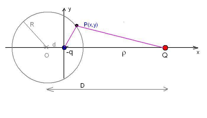

Here is the image charge method for a charge outside a conducting circle.
It is quite simple to show that in case of two charges of opposite sign there is a sphere at zero potential. The -q charge is in the origin, and the Q charge is at ρ distance apart on the x axis.
We want to find the points P(x,y) where the potential is equal to zero.
U=k\left(\frac{Q}{\sqrt{(x-\rho)^2+y^2}}+\frac{-q}{\sqrt{(x^2+y^2}}\right)=0
\frac{Q}{\sqrt{(x-\rho)^2+y^2}}=\frac{q}{\sqrt{(x^2+y^2}}
Squared and rearranged, we get the equation of a circle:
\left(x+\frac{\rho q^2}{Q^2-q^2}\right)^2+y^2=\frac{\rho ^2 Q^2q^2}{(Q^2-q^2)^2}
The centre of the circle is at distance ##d= \frac{\rho q^2}{Q^2-q^2}## from the charge q and at distance ##D=\rho+d = \frac{\rho Q^2}{Q^2-q^2}## from the charge Q.
The radius is R= \frac{\rho Qq}{|Q^2-q^2|}
Substituting ρ = D-d, it follows that
\frac{R}{D}=\frac{q}{Q}
R^2=d D
So it is proved that there is a sphere with zero potential in the field of two charges of opposite signs (Q and -q). According to the Uniqueness Theorem if we have a sphere of radius R with zero potential, and a charge Q at distance D from its centre, the electric field is the same as that of the charges Q and -q.
Accepting that the method of image charge, the position and magnitude of that virtual charge is easy to obtain: The potential is zero at the closest and farthest points on the sphere.
\frac{-q}{R-d}+\frac{Q}{D-R}=0
\frac{-q}{R+d}+\frac{Q}{D+R}=0
From these, R/D=q/Q and R2=dD immediately follows.
ehild
